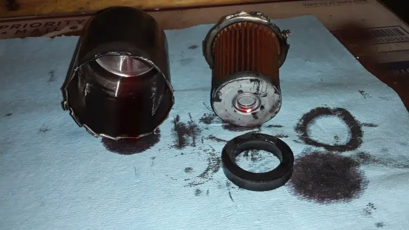

Hey guys, 1996 XLT 4WD v6 4.0l Auto here and I am wondering which line on the radiator is the feed line and which line is the return line back to the transmission?
I am putting in a aux tranny cooler and I know that one goes in series after the radiator transmission cooler from the bottom fitting, but I just want to verify that the top fitting on the radiator is the feed from the transmission?
I want to put a Filtran 3 micron magnetic filter on the feed line before the transmission coolers, or should it not matter and should I just put in in line before the aux cooler after the cooler in the radiator?
Logically I would figure:
Option (A) Transmission -> Filter -> Radiator Cooler -> Aux Cooler -> Transmission
or:
Option (B) Transmission -> Radiator Cooler -> Filter -> Aux Cooler -> Transmission
or if the fit would be better:
Option (C) Transmission -> Radiator Cooler -> Aux Cooler -> Filter -> Transmission
So, input on which is the best option and which line is the feed and which is the return on the stock cooler in the radiator (top/bottom) would be greatly appreciated.
