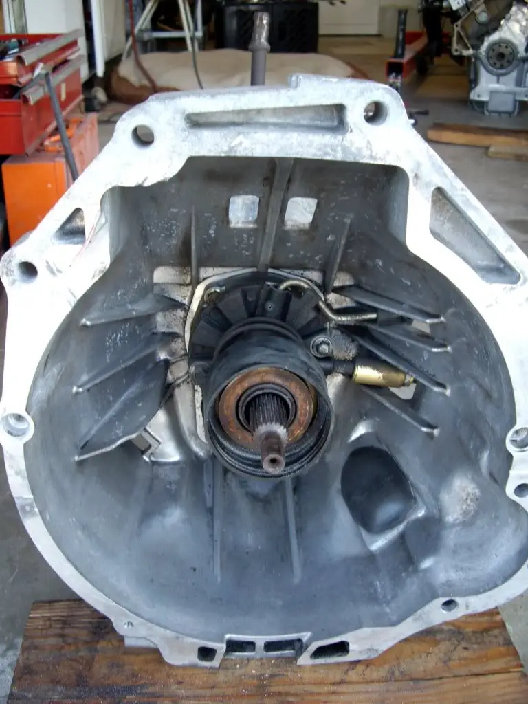

I'm only going by what is posted in this thread:
http://www.explorerforum.com/forums/showthread.php?t=127919
Although this looks to also be a 3.0 bellhousing:
Regardless they're for sure different and won't mate up even if the internals are all the same.
And on a side note, if you're so ****y and think they're the same why did you post this question?
That is a manual transmission, not an automatic. The manuals had starters on the opposite side. Besides it doesn't matter on the engine where the starter is, just that it engages the flexplate/flywheel.
