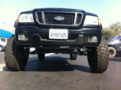

Those look mean! got a full shot of the truck?
Thanks buddy! I can't decide whether to go with 16",15", or 17" wheels on my expo which is why i ask. After seeing pictures of this ranger with 15" wheels it had me drooling
and this last one i could not resist... his suspension set up is so nice... I like how he went all out and did better brakes and hubs
