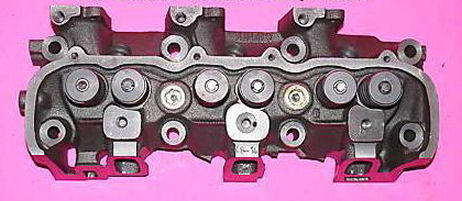

I don't think this is going to work. The coolant passages are way different! Here are two pictures of a 2.9 head and the 4.0 head.

Finally found a picture of the bottom of a 2.9 intake and it appears that it would take some very serious re-working (cutting, welding, etc) of the intake to change the location of the coolant passages! Bummer.......

yeah the 2.9l passages are underneath the intake passages while the4.0 ones are on the end of the heads. guess its back to the drawing board on the 4.0 swap, i suppose ill be doing a lot of wiring haha
