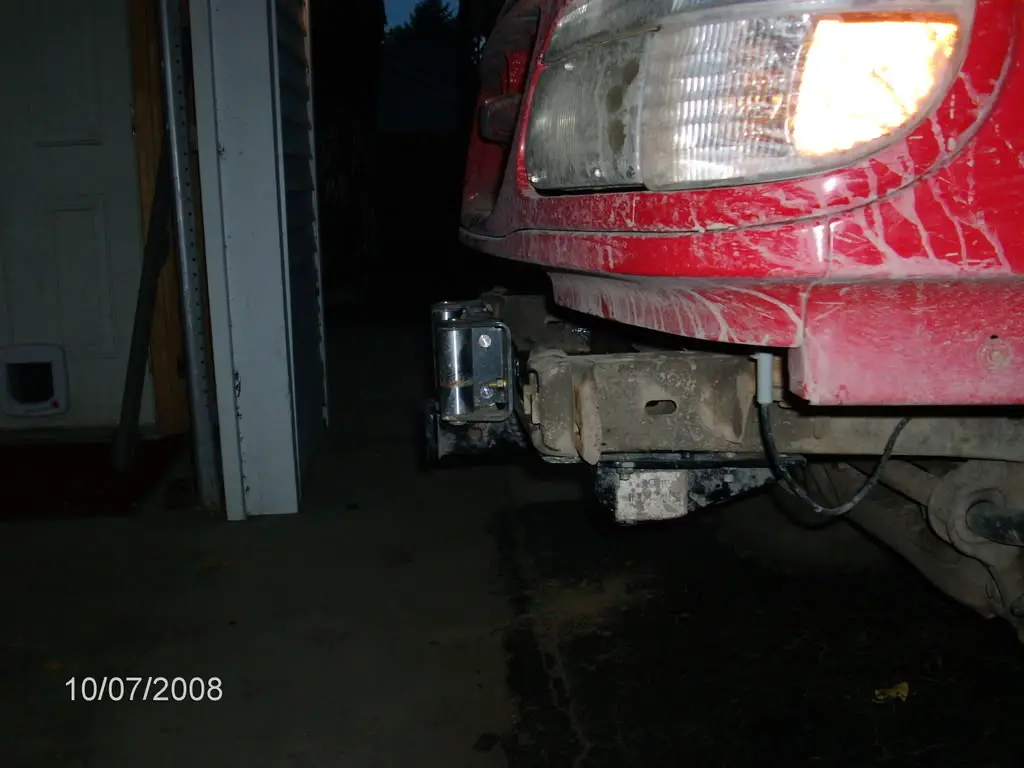

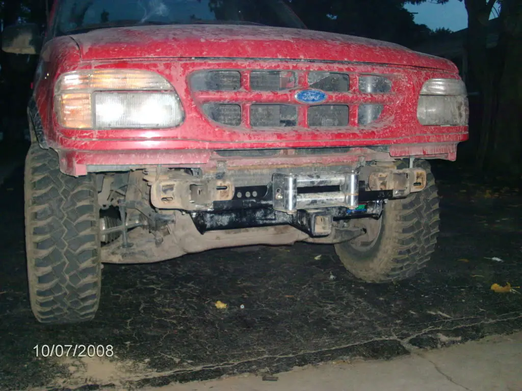

Well after wheeling a few times with the reciever multi-mount winch, i have discovered that it hits just about everything on the trail. Though it does work well, it gets annoying hiting on everything.

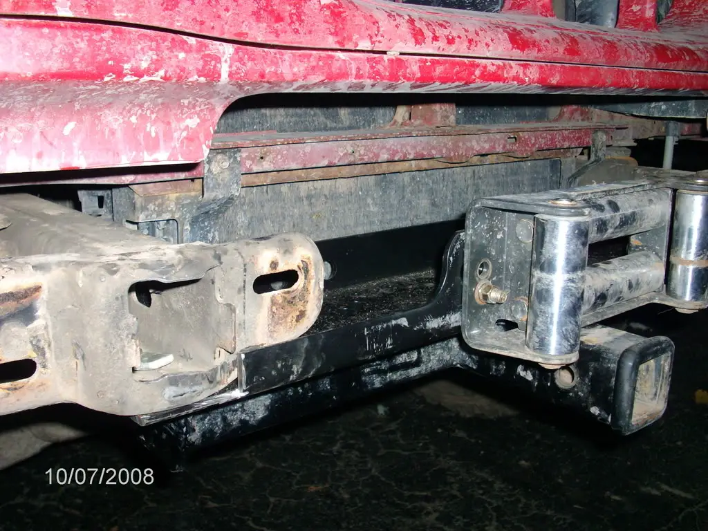

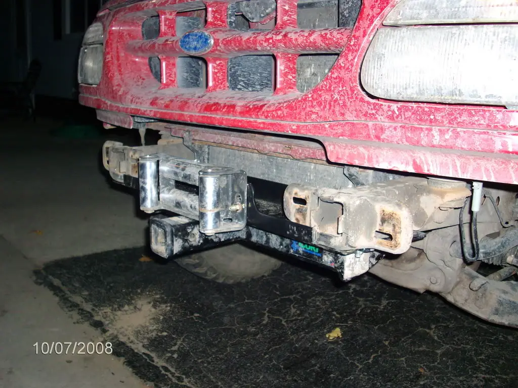

So after a little cutting and grinding to the "jeep" mount that came with the winch, i have got it to bolt up between the frame and receiver.
Question comes when fitting the winch, it won't fit unless i remove the part of the core support in the picks (it's red). Is there any major reasoni shouldn't cut this? It doesn't seem to support anything.
I think i can modify the bumper to fit again,
i wouldnt see why you couldnt cut on it, if you need i would reinforce it with some steal up and over you winch when you get it where you like it. by the way i like that set up you have when i get some time i would like to make a hidden winch mount like yours so all you see is the fair leads
