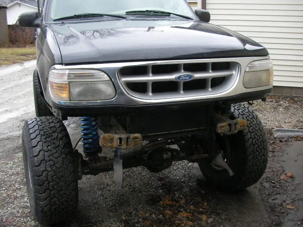

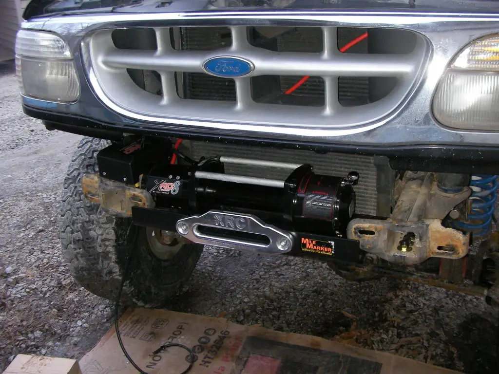

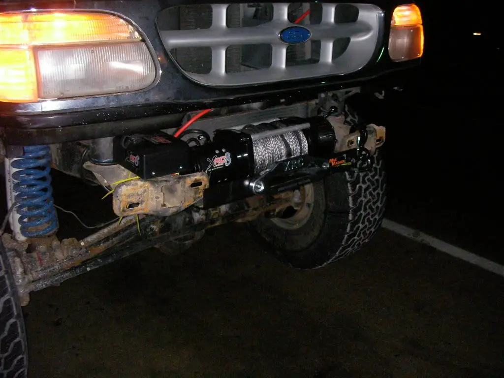

Got the winch mounted today and thought i'd share some pics.
Winch: Smittybilt xrc8
Mount: MileMarker made for a jeep.
The solenoid is in a temporary spot hince the yellow zip ties....

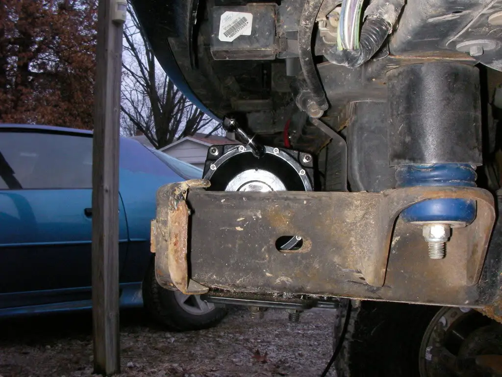

pretty crafty. looks like a mounting option i could afford. did you just drill into the the frame and attach it, did the mounting plate need to be modified at all?
drilled 4 holes in frame and used 2 existing holes. The mounting plate had pre-drilled holes that were a little off from center; they were wider than the frame. So I made the holes a bit wider so they would line up to the center of the frame. 6 grade8 bolts holding it on.

I like the way you have it tucked in there.
Unless he's used the winch, I would think we would have to wait untill he's made a few pulls with it before any opinions, other then looks that is.
Did you add the rope or was that factory?
The rope came with the winch. and I haven't tried it out yet. But going out this weekend and hope I dont need it but its there lol
