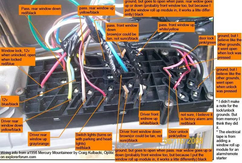

I would pull the driver's door switch panel and check to see if power is getting in and out of it, as well as continuity to ground. There are wiring diagrams for this linked in my sig but this picture should also be helpful:
Based on the intermittent nature of the widows working, I would still suspect a frayed wire and you might find that if you open and close the driver's door a few times, they start (or stop) working again, at least for the time being.
