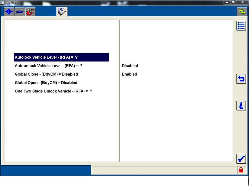

I was able to get remote close working in my 2017 Limited via FORScan.. i am able to hold the lock button and the 2 front windows will close and in FORScan you can have the toggle option appear in the settings menu along with Remote Open
So is it opposite for close, lock then hold lock? Once enabled in forscan
Correct. You just have to press and hold (single press to avoid the horn) the lock button and the windows will close
Ok, nice. I'll have to give that a try on my 19. Love the front down with the fob, just wish up came enabled.
In case it's of use to anyone looking to activate this on a 2016 explorer, limited trim but should work on xlt, sport and platinum. You don't need to deactivate accessory power( couldn't find where to do this anyway) and you can get both global windows up and down working.
What is needed is to enable global windows in Body control module, IPC(enables menu), DDM and PDM using Forscan or IDS. I used forscan.
In Driver and Passenger door modules, all options related to global windows should be enabled.
Auto down requires the second key fob press that opens all doors and then holding for 3sec simultaneously. I figure this second press will awaken the PDM and only then can global window down work. If you delay before second press, a single press is initiated a gain and auto down won't work. I beleive this can be bypassed by setting door unlock option to 'all doors' in communication interface.
Auto up works from first press of the key fob and hold for minimum of 3secs, as stated in previous posts.
