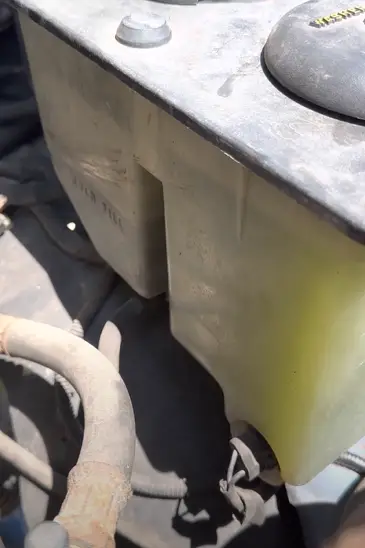

- Empty both reservoirs, and remove the box from engine bay. Mine had two 8mm screws, each side of this box. Had to disconnect the windshield hose at the box, and disconnect the hose to radiator at the radiator neck.
- Once you have pulled out the plastic box, locate the pump. It will be at bottom, tucked in a hole down on that box.

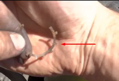

- To keep this pump at it´s place, there´s one ring. Remove carefully this ring, because we need it at the end again . Be gentle, I mean don´t get it out using a wrech and a hammer... this one, at the pic, is broken .
- Once removed, just pull the pump , it will slide out. On this case, you can grab it with some plier by the connector edge.

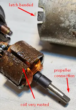

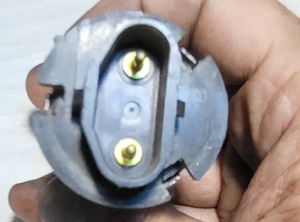

- Now, we have to unlock the other part . There is 3 hatches, which we need to turn that out. Take a good look, because we will need to bend it back at the end.
- Once it is bended outside, you can slide out the connector with the rotor.

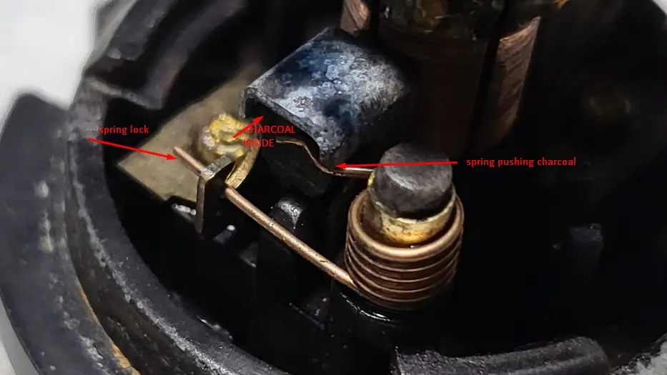

- As this is a eletric engine, it have bushigs, like any one other eletric tool.. here a detail of it:
- unlock the spring, and mind the spring position: the twisted side is up. Now remove the spring, and the charcoal must be loose. do this both sides.

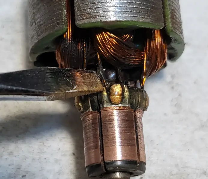

- Do a visual inspection at these wires. Mine had some toasted, but not much. if you have wires burned or snapped at this point, probably it will not work, or will work with low power.
- Now clean it all. All parts. I washed with CAR-80 and a toothbrush, washed with water, washed with dish soap and scrubbed again with toothbrush, washed with water again. Once it get more clean, begin with sandpaper.

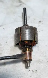

- Using sandpaper, get rid of all rust, and any bump.. get it very smooth. keep in mind it will rotate, and can´t grind .
-Its clean and sanded. Some spots still exist, but cant even be feeled .. it is smooth. This part indicated at the picture above, must be sanded carefully, just to remove some dirt. This is where the electrical contact are done.

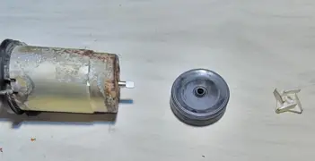

- Pull the white part . It will slide out, that is the water propeller, it fits in the axle at one position only, mind it because at the end we will need put it back.
It should be like this :

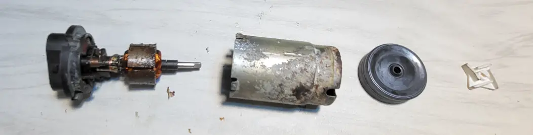

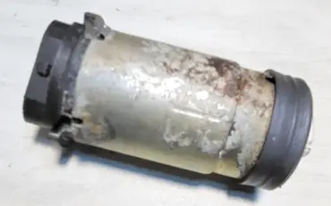

- And now begins the cleaning. In my pump, i had a lot of rust and dust. Is essencial to clean it all , make it mint. I have used a CAR-80 degreaser/decarbonizer, and some sandpapers.

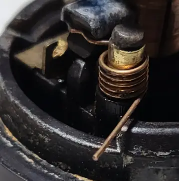

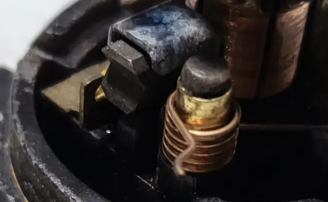

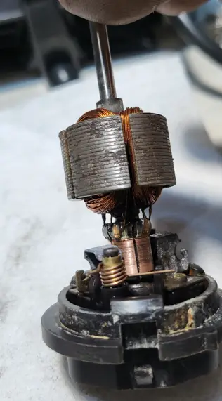

- With these loose, remove the axle. just pull it.
Details:
