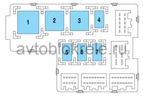

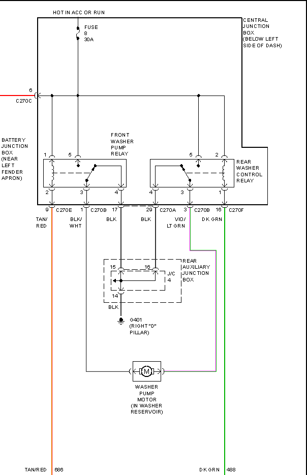

Can someone tell/show me where the windshield washer pump relay is located. Wipers work, but no spray, washer pump motor tests good. Thanks!
cant find anything on the web specifically but relay 3 in the top passenger side says "delayed accessory" not sure if thats it? consider this a bump!
