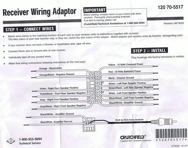

Hey guys...I am also doing this but I am really confused as I am hearing all different stories. I bought these 2 harnesses from Crutchfield and received this exact same wiring diagram:
This is the back of my HU:
this is the back of my factory radio:

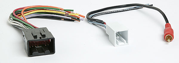

When I installed the new HU, I only used the harness on the left in the picture above...which plugged into the harness that fits in the bottom right corner of the factory radio...
There were 2 plugs that went into the factory radio from the car. I did not use the other one and it is just sitting in there because I didn't realize that it would into the white harness on the right in the picture above...
Now my question is, when I plug the white harness in the picture above into the unused adapter coming from my car....what goes where?
I believe the RCA goes into one of the subwoofer ports on the back of the HU, does it matter which one?
And lastly, where does the blue wire with the white stripe go? Obviously the black is a ground (right? :X)
Thank you all so much for your help. This forum as helped me a lot!

Vinnie,
I bought the same two harnesses from Crutchfield for my '02 Mountaineer and got my factory sub working without any problems.
The RCA goes into one of the sub outs on your headunit, I used the left rear on mine (usually the mono out) but I'm sure any of them will work. The blue/white wire connects to the remote wire on your headunit (usually a bright blue color and probably fused). I wired the black (ground) to the same ground that the headunit used.
You'll be amazed at how good the factory sub sounds with a new headunit. Good luck!

I know it's been a while since you posted. But here's your answer if you havn't found it already.
The blue/white wire for the sub turn-on should connect to a similar wire on your RADIO's harness. The radio should've come with it's own harness that you attached to the CAR harness. On most HU's there will be a remote antenna trigger and a remote sub trigger line. Hook it up to the remote sub trigger with at least a 2.3k or 5k resistor. Preferably like others said here use a voltage regulator.
I'm in process of doing my 06 so I'll take pics and video and whatnot to help people along. It's not all that bad. What will suck is when I try to make the remote steering wheel controls work. That looks like a pain in the behind.
--Chris
--Chris

I too have purchased this harness kit from Crutchfield (although mine has a white RCA not red?). I am wondering if I need to y split the RCAs, seeing as the harness has only one plug and the head unit has both red and white. Or does it matter? And, like VinnieZ said, "Which one"? (I just plugged into corresponding color)Hey guys...I am also doing this but I am really confused as I am hearing all different stories. I bought these 2 harnesses from Crutchfield and received this exact same wiring diagram:

It doesn't matter
Heidi Jo i think it doesn't really matter which one you plug it into because they're just left and right and it's only one signal any way so it should be fine how you wired it

Vinnie, your factory stereo set up does NOT have a subwoofer. If it did, there would be a terminals (and a plug) that fit into the cavity on the upper left of your factory stereo. That plug would fit into your white plug in your harness kit. The RCA is a nice touch because it allows you to plug right into your aftermarket stereo sub preouts. The blue wire with the white stripe is what "wakes up" your amp. It actually turns it on. It does NOT power the amp.
By the way, do not confuse the word AMP in that set of plugs to mean it has anything to do with an ampifier. It's the name of the company who built the plug.
Heidi, most sub outputs are mono...so using just one should get you by. However...even though it's mono, your aftermarket stereo can vary output from side to side. Not all...but some do. So to be safe, I would run to Radio Shack and pick up a Y adapter. They are cheap.
If hooking to a factory Ford amp, either resist the turn on voltage, or do it correctly and order this:
http://www.sminntech.com/ampinterface.html
Ford amps only want 5V on the turn on line.

Thanks for the info cobra.
I did end up "y"ing the sub RCAs. And I ended up just making my own 5v regulator. Just used the specs from Sminntech's diagram. Would've been easier to just buy one from him, but I couldn't see spending $11+$6 s&h for a part that I could make for under $5. It was super easy and I already had most of the parts laying around. Yay. Now I have a stereo that PUMPS!!!!
Maybe someday I'll make an attempt to put in some better speakers. But for now, I'm good.
