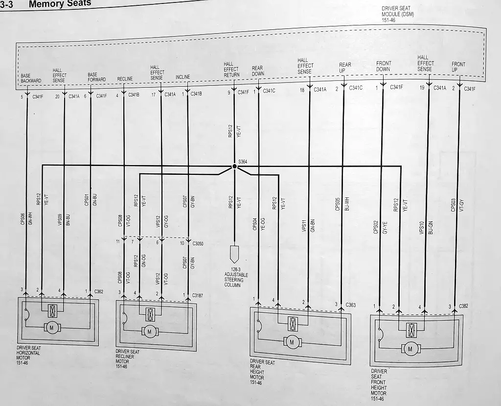

Hey, I'm swapping 2013 seats into my 2016 police interceptor. However, the passenger side works great. The drivers side does not. Did you run into this?
