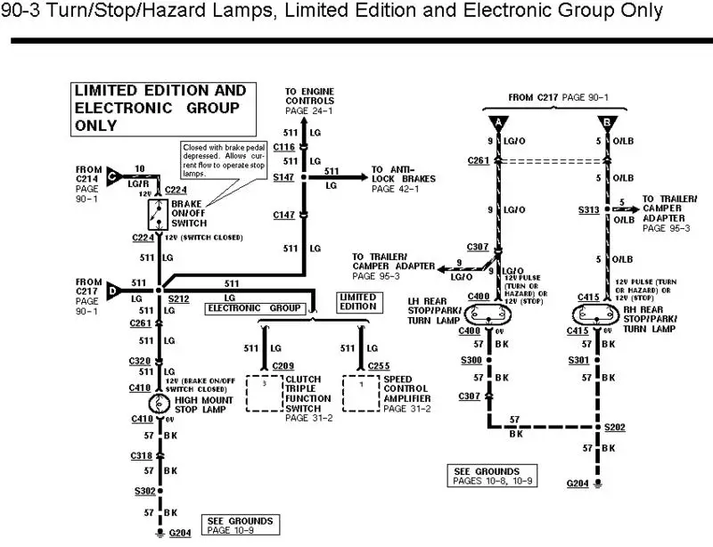

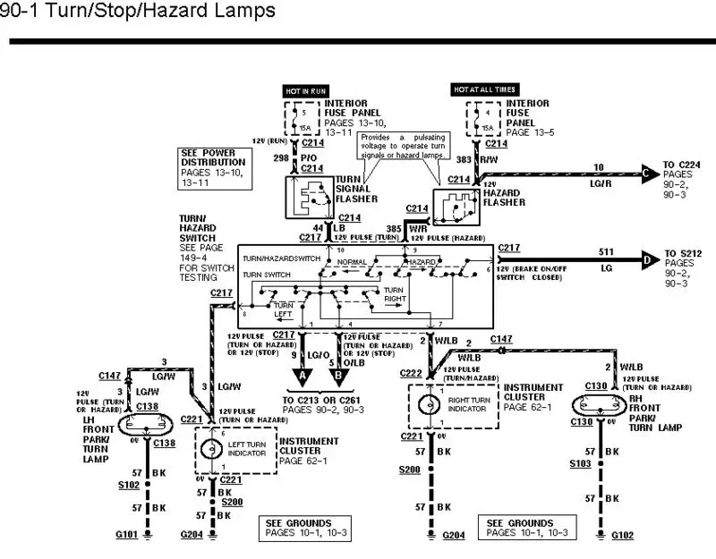

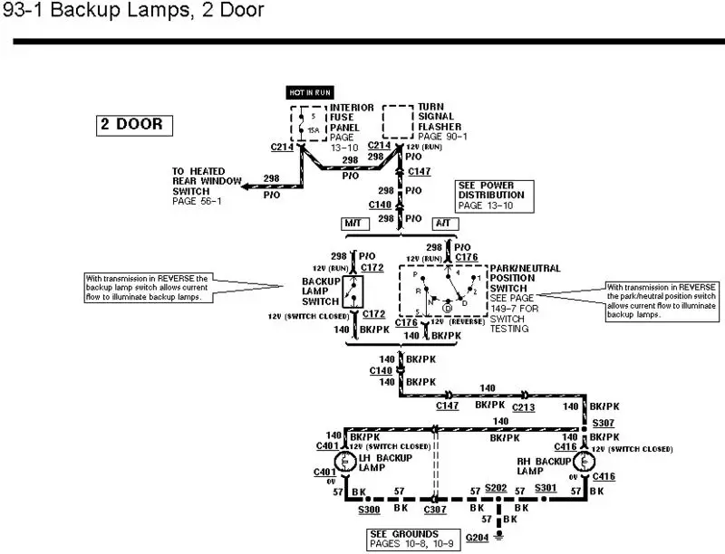

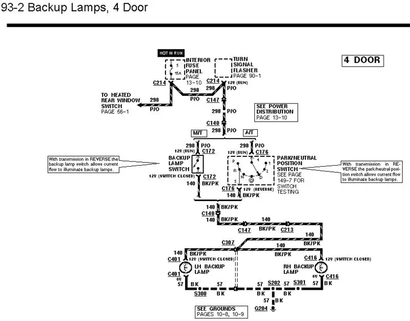

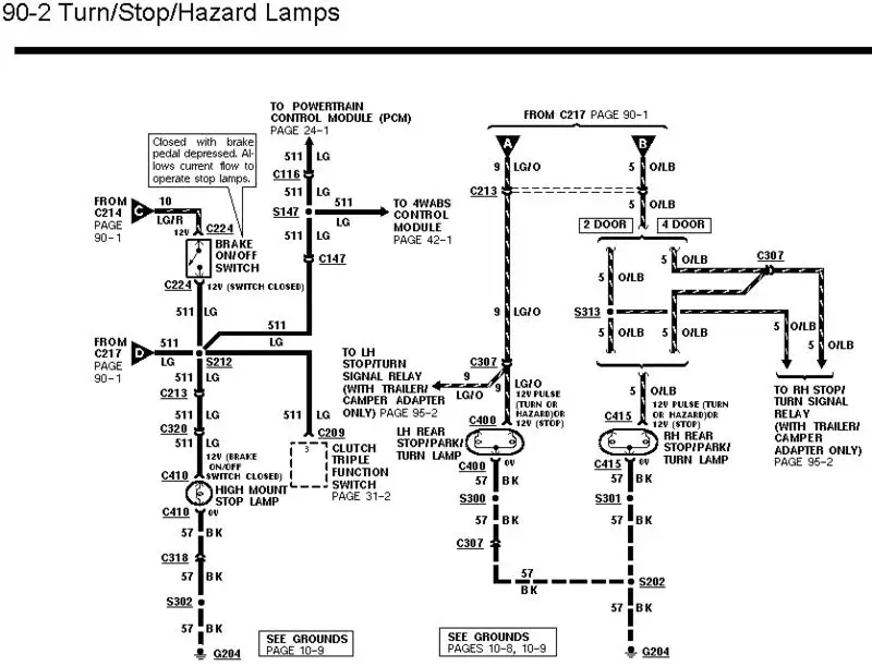

Hey guys, I owned a 1994 Ford Explorer XLT, and I am having issues with an electrical problem. Everytime I put the car in reverse, there seems to be an overload. I see the lights deem out and the battery gauge fluctuate a lot. Also, the fuse for the brake lights bows out. So now I don't have any brake lights and no hazard lights and when I put it in reverse, the brake lights turn on without me pressing on the pedal. Any ideas as to what this may be? I also am looking for some good wiring diagrams. Thank you.
Welcome to the forum!
Hope these diagrams help. They're for a 1994 but may interchange with earlier models.
