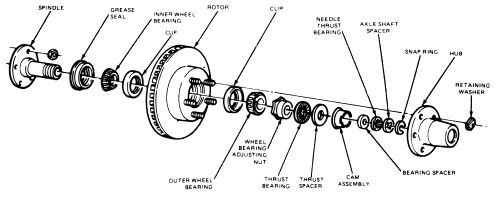

I'm confused :confused: Are you sure talking about HUBs or a spindle? A spindle is pictured below

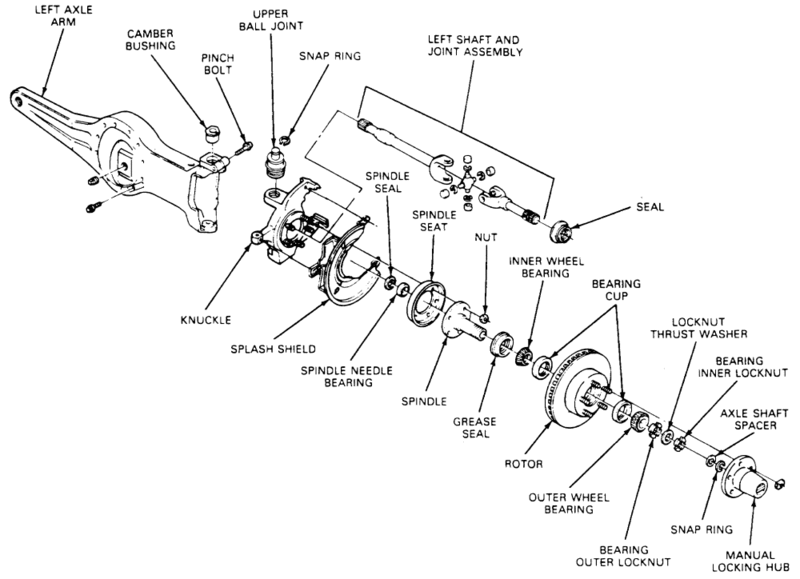

Maybe he didn't put the splined washer back on before the C-clip and the axle shaft is slipping inward and out of the spindle?
Spindle it is
It is the spindle I am talking about, the axle shaft is slipping inward as WickedWindsor says. My memory tells me that there is suppose to be some kind of rim on the inner of the spindle to block the shaft from going inward. I dont remember any splined washer going before the c-clip ???? Or did I run without it for all those years ??? I'm running Warn manual hubs (converted several years ago. What would that splined washer look like ?:wtf:
Hubs
I will look what I have left from the old auto-hubs, and see if i still got the installation instruction from Warn, maybe I missed someting back then.Specaily the axle shaft spacer that would look like a solution to my problem :confused:
Yeah!!
I feel a little dumb :banghead:, been running all these years without the spacer (7 years to be more precise), dont understand how it ran.... Now I have another question, about the seal on the shaft (the one beind the spindle/knukle assembly). Is it a 1 part or 2 part seal, the reason I'm asking is when I repalced mine 6 months ago, there was none left to compare and the dealer sold me a 2 part seal. When trying to install the axle shaft spacer I could not get the shaft out enought to install the snap ring. I then looked at the seal assembly and finally remove the plactic/metal ring part that looked like it was there for noting and it all came togheter great. Sorry if I cant explain more accuratly, I dont even know the part name, and it does not show on the exploded view in my manual..??? Can someone shed some more light on my darkened mind.

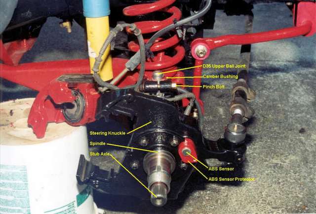

Wrong, as I said in his other thread, all front axles will have some sort of spindle. Look at the expanded view of the 4x4 axle a couple posts up. The spindle is clearly labeled.
then why is it on the lift kit sites say for instance my year Lift Spindles (for 2wheel drives only) thats what it says on the websites...
Because lift spindles don't work on 4x4 because of the CV axle's. If you do a 3" spindle lift, for example, the CV joints will bind and fail. The spindle is in every kind of front axle.
the spindle (label) is pointing to the wrong thing it's actually the black piece in the pic :)
