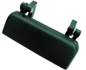

My old 91 had a door handle break.....from what I remember there was a small tab that one of the links went thru on the door handle that broke off.....not the best picture but......if you go to Rock Auto they have handles listed....

hello fellow winterpeger (well, selkirk for me, but its close enough). if you have to take the latch out of the door, they can be a little tricky if you have never done one before. most commonly the spring on the door handle breaks, and leaves the handle to flop around when driving (and makes a rather annoying sound as well). if you have to replace the handle, you will also need to drill the old rivets out. if you value your paint, and you are replacing the rivets, put cardboard under the handle, that way when it snaps the rivet pin off, you wont hit the door with the rivet gun. however, you can also use regular nuts and bolts to put the new handle back on. have fun, stay warm.
