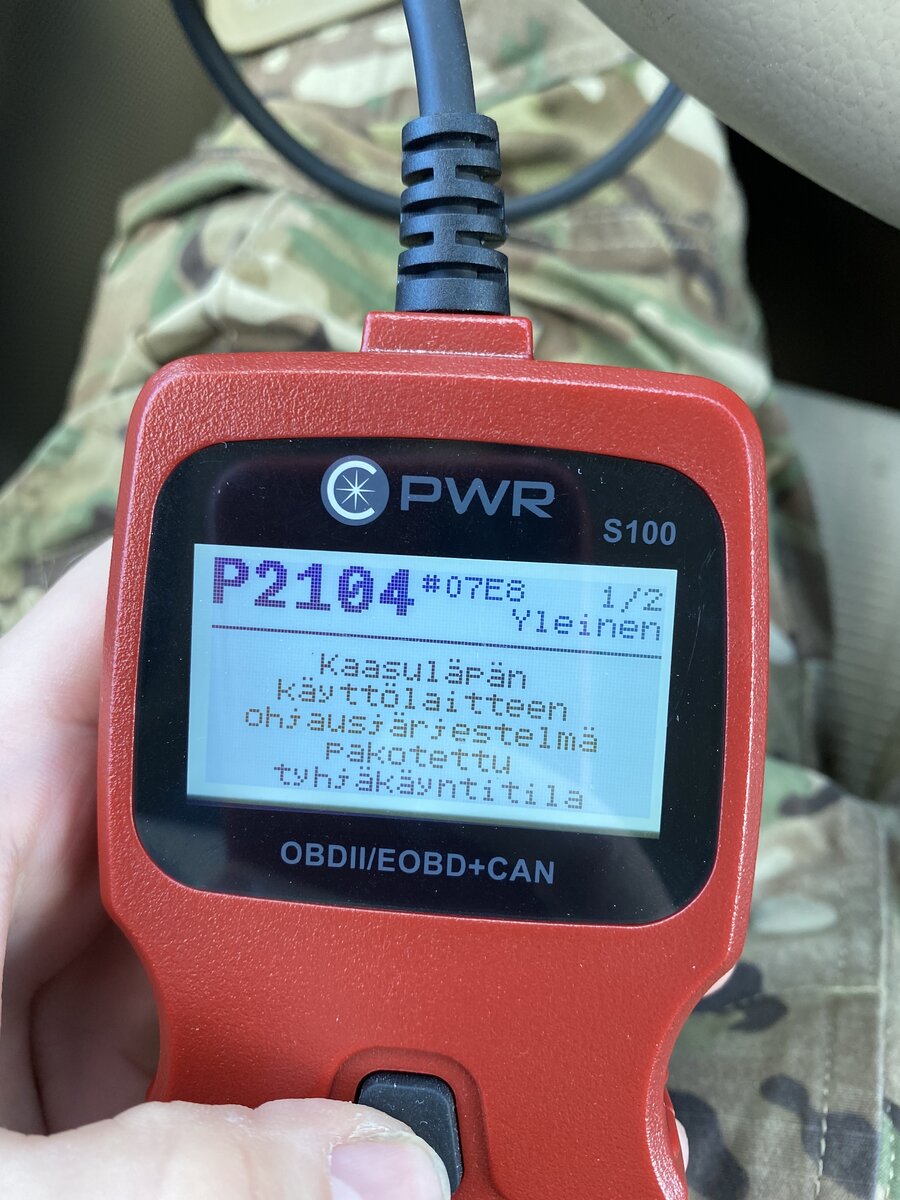

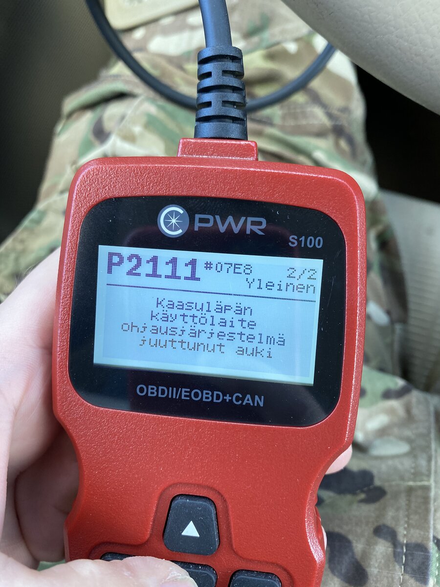

Nope. Didn't fix the problem. After 15 min of driving yellow wrench came up and codes p2104, p2111.
