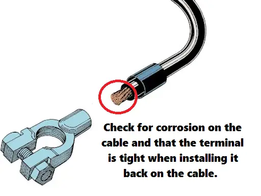

The fact that most circuits you noticed seem to have no power, I'd check your main battery cables, positive and negative for excessive resistance, a bad connection. The ignition chime draws less power than a window motor. On the + side, pull it off the terminal and set the meter to ohms, one probe there and the other at the fuse panel connection. If that is good, check the grounds next.

Sounds like my turn key to on, everything normal, turn to start, everything dead issue I had. Ended up being corrosion between the positive battery cable wire and the terminal itself. Replaced terminal with brass unit, and never had the problem again.

Thanks all. We found the issue (hopefully total issue). The simple fix. Mechanic could hear what sounded like short at battery. Cleaned ground wires (done not long ago), reconnect connector & install back on post. It started right up!
