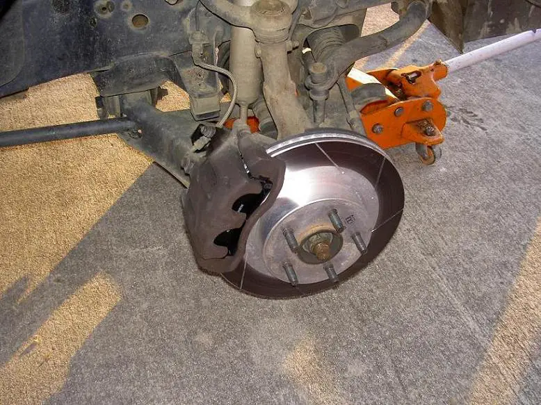

I also like the rotors from EBC, and cryogenically frozen versions. I prefer EBC pads, as I've tried them all, and the one set of Hawk pads on my "big" brake truck, lasted less than two months. They were the red race pads which came with the SSBC calipers, my truck ate them while delivering mail.
