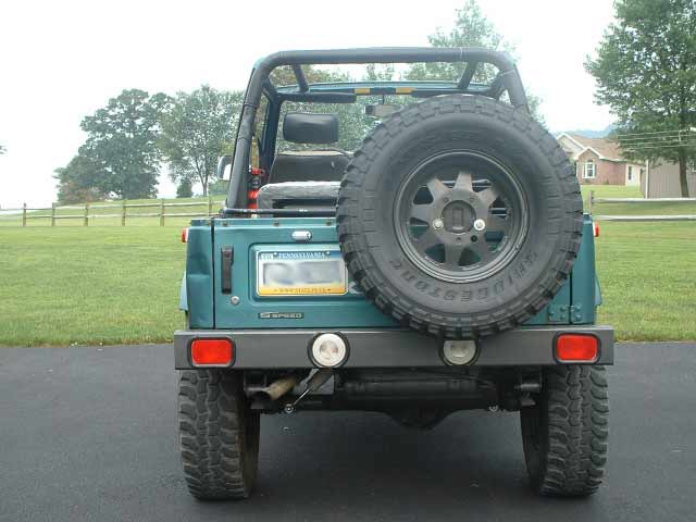

Here's a pix of the new rear bumper installed. I still don't have my bumper side plates from the shop yet. They are 1/4" thick plates shaped like the original bumper pieces and are designed to protect the rear corners of the truck.

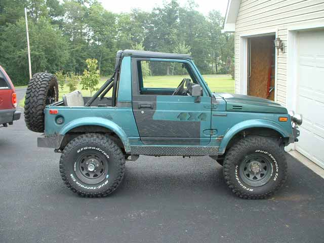

Just thought I'd add a flex shot. I don't think I'm quite fully extended here, but it's getting close!
The Zuk works REALLY well on the rocks!!

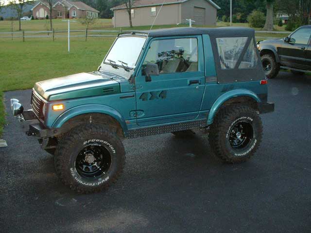

Adding one more picture to this. I'm now running on BFG 32 x 11.5-15 M/T's. Now I'm gonna need new rims since they rub at full lock :rolleyes:. Gotta get less backspacing.
Finally got my new rims from 4WheelParts.com. Only took 'em 6 weeks :fire:
Only one problem........
Now I'm gonna need new fender flares to keep it road legal :rolleyes:. It's always something!!

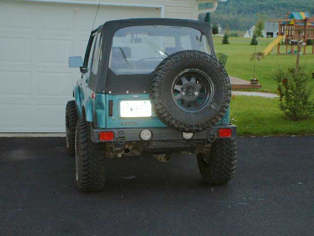

Just thought I'd post a recent shot...photo courtest of Tara. (ExplorerSport77)
