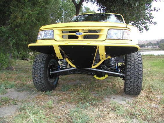

LT Kits and beams are available from several off road fabricators
Check out Mcneil, Autofab, Camburg and more

The reason for doing a cut and turn on the beam is to eliminate the drop brackets for the axle pivots, they are considered the weak point of the TTB bolt on suspension kits. If you look at my truck pictures above you can see I am running a 2" Duff drop bracket at the beam pivot (blue) and a 6" Skyjacker coil (red). The Skyjacker and Superlift kit come with 4-6" drop brackets to locate the beam down that far.
So if you are considering some custom beams with the camber/caster correction built in you will want to get rid of the superlift drop brackets, but it will be difficult to run 6" of lift coil (5.5) with stock pivot brackets (LOTS of cut and turn built into the beam) This is why companies like Autofab will also re locate the ball joint, so you can run 5"+ of lift coil with stock height pivot brackets.
Easiest way to see this:
You see how fab shop beams run at such a steep angle (more ground clearance)?
Then look at your TTB, the beams are almost parralell to the ground.
You can buy stage I, II, and III kits, or just bare beams.
I see them used alot on the dezert boards, but you must be really careful, this can be a rats nest if you dont know who built them, how much alignment correction is built in, how wide the axles hafts need to be (custom shafts = $$$$, 200 each or so typically), etc

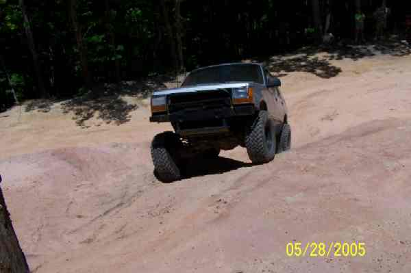

I'm getting more than 12" on my own setup without drop brackets, cutting or turning, etc. Of course, my parts are sort of loose from wear, but I'm getting more than I ought (travel wise) with no serious problems.
I found that shocks and free length of the spring (brake lines) were the main limits on travel, so I addressed those issues.
I'm running 1979 F150 4" lift springs, F250 shock mounts modified to take a stud shock (have an extra set for sale!), 2005 Dodge 1 ton, 4x4 shocks (long!) and Super Duty brake lines. I'm getting around 16-17" out if this setup.
Not even close to full droop in most of these pics. And yes, I do have issues with the steering, but only at full droop.

I was just looking at my last picture and laughing...
I bunny-hopped the top of that hill. It was so steep and nasty that my wife refused to even take video of me going up. She caught one as I popped over the top from where she was hiding, behind a tree. The guys that watched me do that said that they had never seen an Explorer 4 feet off the ground -- straight up and down -- before. :D
Imagine a 200 foot hill, at around a 45% grade, with stone steps running cross-hill at all sorts of wacky angles - with a straight up 3 foot step at the very top and you sort of get the picture. More typically, we get someone upside down and spend half the afternoon winching.
