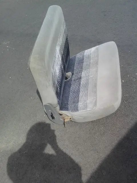

...My "Project X" really hasn't had any projects done to it lately but today all that changed..
..I've been kicking around this idea for a while now and the first thing I needed to do was make the commitment that this fridge is going to stay in this truck most of the time..
..Commitment made..

..I first needed to throw the fridge in it's new spot and check to see what room I had left and what it looked like in "Deck mode" with jump seat down in the closed position..
..Make sure the lid would open freely..(Even with part time fan installed above)
..I need to check space around the fridge and jump seat with seat "Open"..
..and also under the folding "Deck seat/bridge"..
..Then I tested out the fitting of the aluminum floor jack in this area..
..:scratch:..I'm not totally sure where this secondary fuse block is going to end up yet but thought I would toss it in here while I was thinking..
..Before the test fitting was all done their was one more thing left to do...That's right...Sleep in the back over night just to verify nothing else needs to be moved and what I'm tying to accomplish will actually work..
..I did..It does...We are all good...:biggthump
..One of the bonus's of this is the fridge will now be at about the same height as my little action packers in the rear cargo area..It's Kind of a uniform height table area in the back now when moving stuff around or preparing stuff coming out of the fridge..
