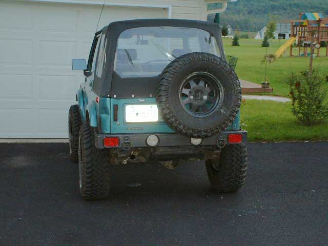

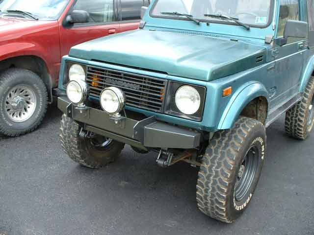

Not from an Explorer, but I made these. The style could be adapted pretty easily to fit an X. Doug and I have been looking at making a similar set for his Explorer, but making the rear bumper double as an air tank, and adding a swing-away tire carrier to it.
Here's the front in "kit form :)
Here's the finished product:
Here's the rear bumper:

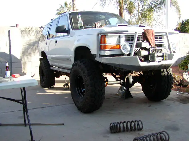

Here is mine that I made for my 91 Explorer:
It is made for a winch but I use a multi mount for the time being.
Here is more info and pics: CLICK

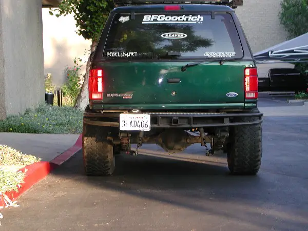

And my rear bumper with swingout tire carrier that I made, details HERE-

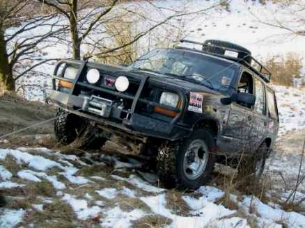

I posted this one several times already... looking for someone to duplicate:
bought it overseas... just got it. It should be on my truck by the end of this weekend.
:D
James Duff Winch Bumper
