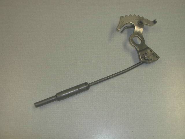

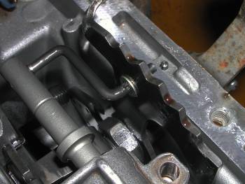

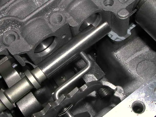

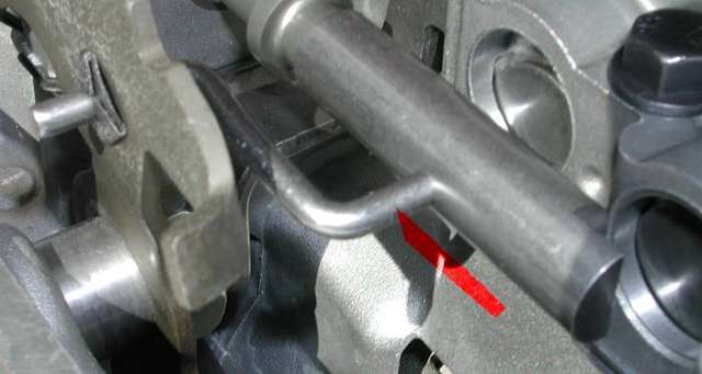

Often we talk about the hook-up to the manual valve from the shifter.. via the "Z" link.... I never captured a good pic of it... so here are a couple
