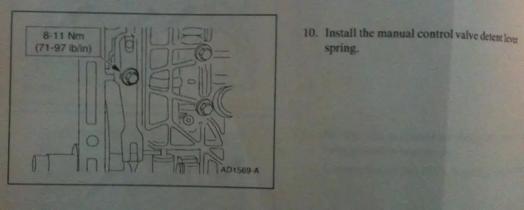

I was having the infamous 2-3 shifting issues, so instead of just replacing some of the solenoids I thought I'd go with a revamped valve body with all the updates from 800700tran.com - complete with all the updates.
A big reason for going with this was the fact that there was some loose valve body bolts were found to be loose when I did a fuild/filter change a few weeks ago.
So, I replaced the valve body as per the official Ford Service Manual and all seemed to go OK until I started it up. No reverse - no forward either...
Fluid level is between the two dots on the bottom of the dipstick. I let it idle for about 10 minutes while I hooked Autoenginutiy (I have the Ford sensor software pack) and it didn't flag anything.
Any ideas?
Two questions I do have:
1.Regarding the low/reverse band servo. It was a little struggle to get it out but it seemed to go back in pretty easy and wanted to slide up and down pretty easily. Could it be that the O-rings needed replacing?
2. Are the special service tool "locating pins" required or is just lining it up using the bolts good enough. The Ford Service manual shows pins 307-333 and 307-334.
