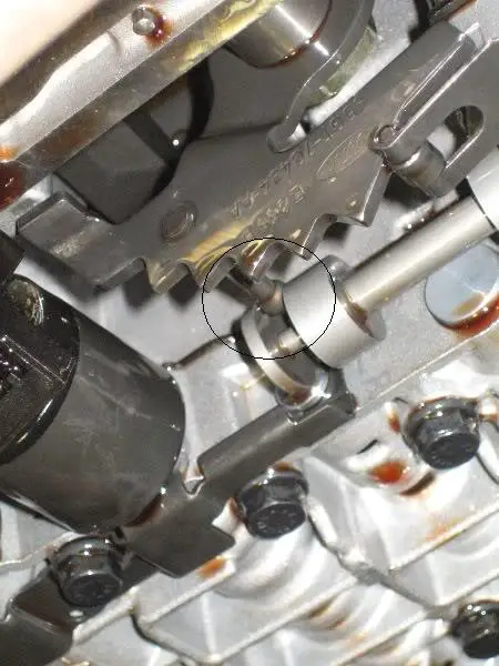

Hello, I have a 2004 Explorer V6 that had OD light flashing. Seemed to shift out fine with exception of an occasional whine around 2nd or 3rd. Had trouble code p0741 torque converter. Tranny fluid was brownish and began to smell. Pulled pan to change fluid so while I was in it I pulled solenoid pack and valve body.
Separator plate gasket has damage around the area I think is the torque converter lock valve and the thermostatic activated valve.
Intermediate band seemed real loose. Adjustment made with 10 ft lbs and back off 1.5 - 2 turns.
Everything cleaned well. Found some metal fines on magnet. No chunks or parts in pan.
Replaced the separator plate with new one from Ford with bonded gaskets. Torqued everything down and refilled with Mercon V. I put 8 quarts in and am not getting any overflow out yet. Truck will not move forwards or back now.
Does it sound like I still need more fluid or does it sound like I may have done something wrong?
Any Help Please. I'm out of vehicles as my truck spun a rod bearing and my other Explorer lost its transmission 6 days after that.
Thanks
