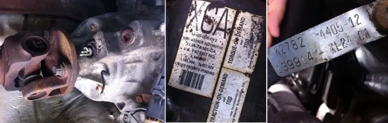

Well, after becoming super busy and not having any time to look further into the 4x4 issue, I was changing my oil today and noticed wires were cut from my front transfer case. Something had to be stolen before I purchased this car! Any ideas what it could be that I'm missing now? There are 3 wires together cut and one a little lower to the left alone that is also cut. Any ideas will be helpful!
Ok I think I found the issue. Next to the transfer case motor/wires, there are some other wires right under the driveshaft ON the transfer case. Three wires together and one lone wire to the left of that bunch are all cut. Just need to know where or what they go to! Looks like a part was stolen right before I bought the truck. I just don't know what part. The transfer case motor and all the wires are all intact I believe. Just confused as to where these wires go! Thanks for your help/suggestions.
Looks like an Output Shaft speed sensor is broken off in the case. BUT, without looking at mine I'll have to stop there. I was thinking the TSS & OSS were on the transmission case. Does it appear the transfer case has been changed? Is there a tag under one of the t-case bolts? Is there a white plastic label on the case?

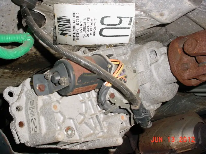

Jerry, or one of you guys post a pic of the back of your t-cases? I have pics of the greasy side of my 4x2 but not the t-case on my 4x4.
Beats me? Here's mine.
Looks just like mine.
Zach, from the photos you sent me it appears someone has swapped in a model 4405 t-case when you should have a 1354. I'm having that verified as now. If that is the case then the cheapest thing may be to find a 1354 and put it back like it's supposed to be.
We can post up on the transmission forum and see if there is an alternative, once this is verified.
EDIT: From my super partsman Roger: OK. The transfer case he has now is for a 2000-2001 Explorer/Mountaineer. The one he should have is 1L54-7A195-AC. Looks like someone swapped the t-case.
oh wow! Thanks! But the real question now is can I get this transfer case to work correctly? Or will I have to swap to the original TC in order to have 4x4 again?
