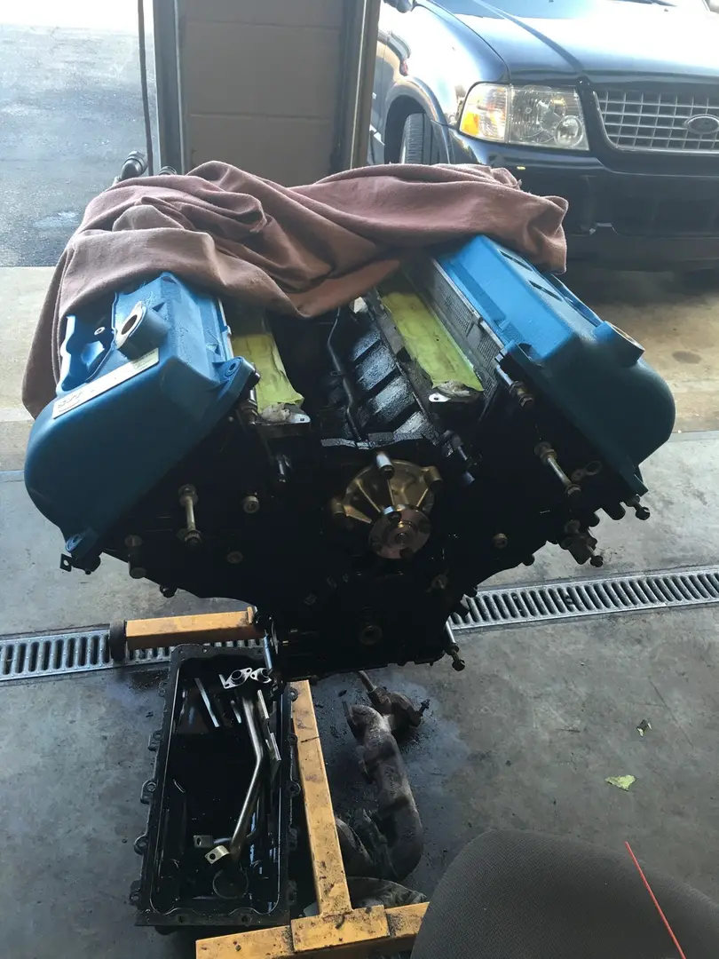

I almost have the terminator ready to go in. Had to replace a couple secondary timing chain tensioners, and all of the gaskets. I thought I was going to need to splice an oil pump pickup tube together like I did with the mark viii engine. I discovered that ford made 2 different tube sizes. My current engine has the smaller tube and the new engine is the larger. When I put the mark viii engine in I cut the lower portion off of an '07 3valve explorer pickup that I had, and welded it to the upper portion of the mark viii pickup. I now know that the 02-05 explorer 4.6 2v had a smaller diameter tube and the 06-10 4.6 3valve has the larger. I could have just bought the earlier style tube and not had to weld anything. Smh. Oh well, 1 less thing to worry about. I just need to get another side project done and I will be able to put the new engine in. Hopefully around the first of April I should get started on it. I can't wait to hear that kitten strangler moving some air.

This is all I have so far. But it's ready to go in. New cams installed and resealed.
Explorer
Yes, like it is sneaking around the corner to see it's new power plant!
Yes, it's wrinkle finish blue.
