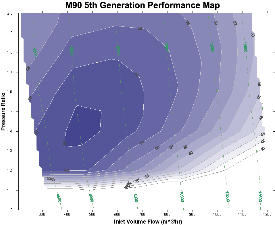

A m90 is almost pegged on a 4.6L... an m112 is big for a 4.0L, I may not be running an intercooler, so the increased efficiency at the equivalent boost level from the m112 will provide a lower IAT...
(4.6L * 6000rpm * 85VE * ((6lbs + 14.7)/(14.7)))/ 5660 = 583CFM * .02832 = 16.5 Cubic Meters / min * 60 =
992 Cubic Meters / hr. @ 1.408 pressure ratio.
(4.6L * 6000rpm * 85VE ((9lbs + 14.7)/14.7)))/5660 = 668CFM * .02832 = 18.9 Cubic Meters/min * 60 =
1135 cubic meters/hr. @ 1.612 pressure ratio.
(those numbers in the map are the HP requirements to run the supercharger)
