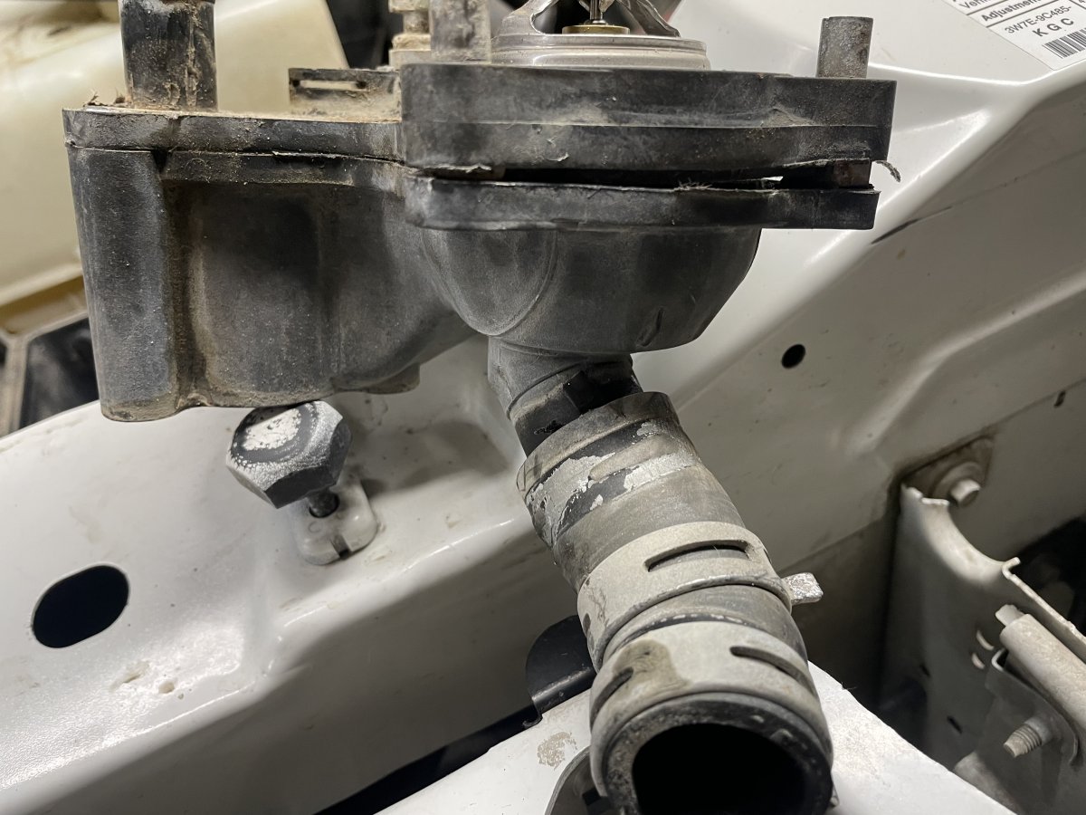

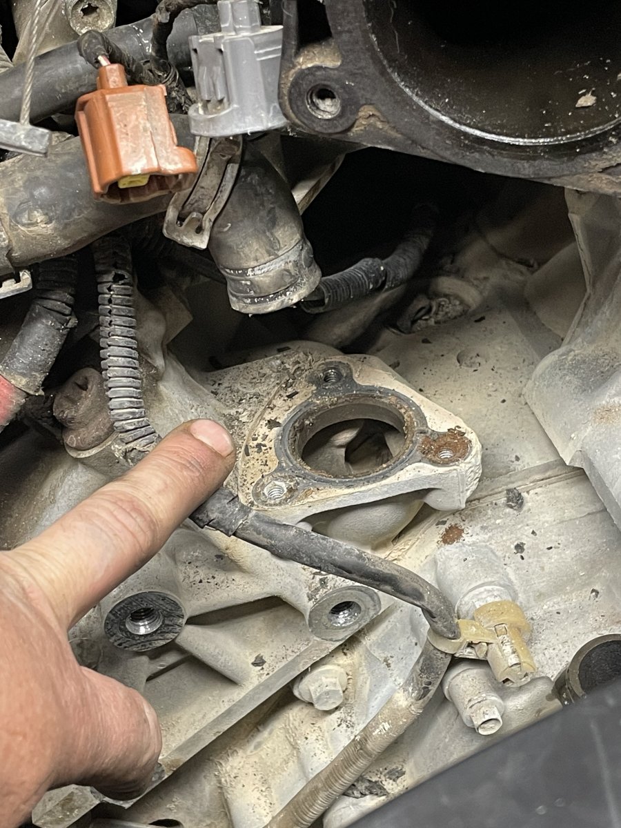

DAM!!!!All was well in sport trac land and then boom it happened. Overheated, lost oil pressure engine quit. Wife was driving it yesterday with ac on, started to hear ticking noise, then she checked the gauges saw water temp was pegged and she turned off ac… hahahaha temp started to drop but it was too late… tick tick tick she said oil pressure needle started to bounce, heard loud pop… she made it off highway to gas station and it quit. All happened in less than a mile.
Two hours later I made it there with trailer, it fired right up and drove on! I was not expecting that I already had my winch cable out hahahahaha
Dang.
Does not run properly something is a miss, even though the engine is smooth something not correct I can feel it.
So guess who is getting a 5.0 way ahead of plan
Now we know why she was $700
I suspect loss of water even though I see no leaks, will check it out this weekend. She is still on trailer.
