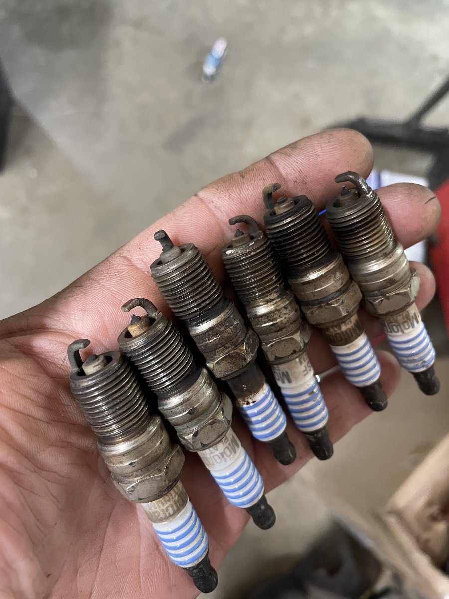

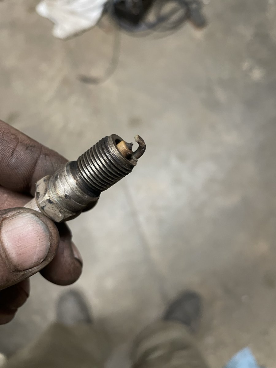

Here are the 6 factory plugs after 235k sheesh at least they got their monies worth

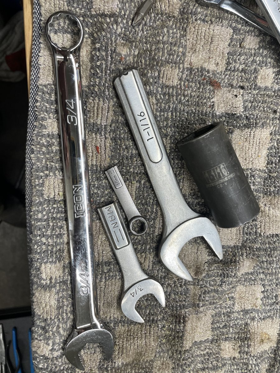

Tools used for changing tensioners

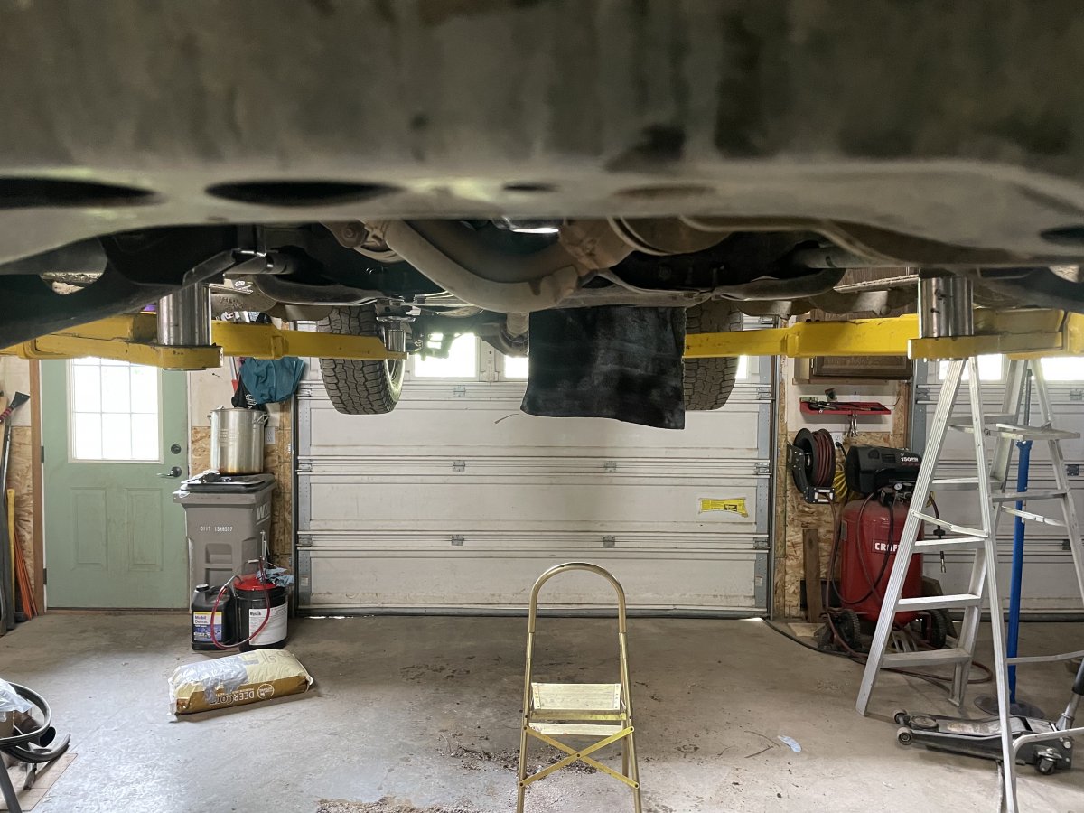

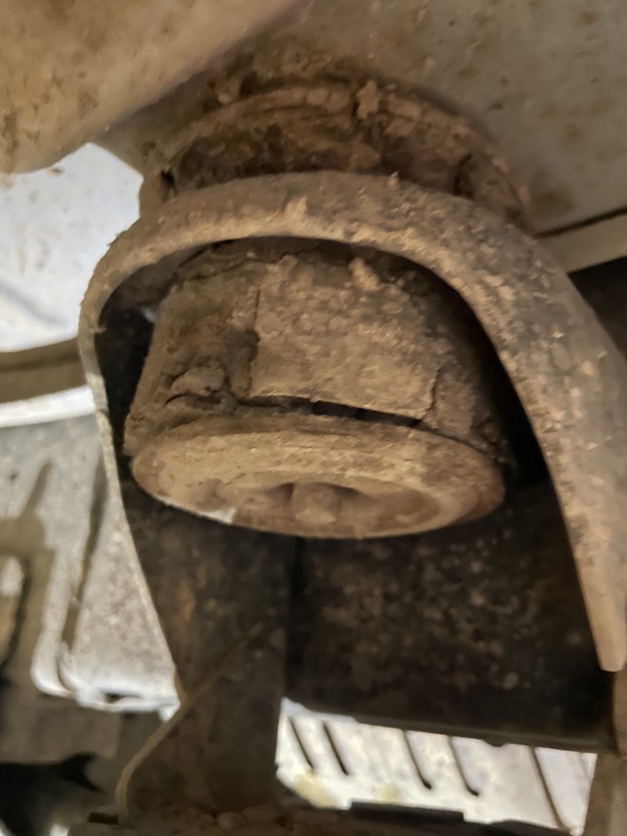

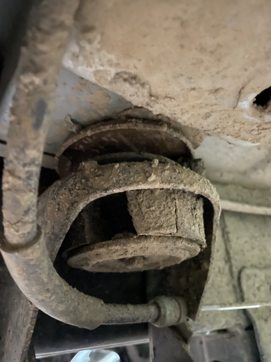

Having truck on lift is good for spotting issues/ future repairs. The body mounts on this trac are wasted. A 2” body
Lift and new mounts maybe on order (if she runs good)
I’ve seen trucks twice this age and double these miles w better mounts?

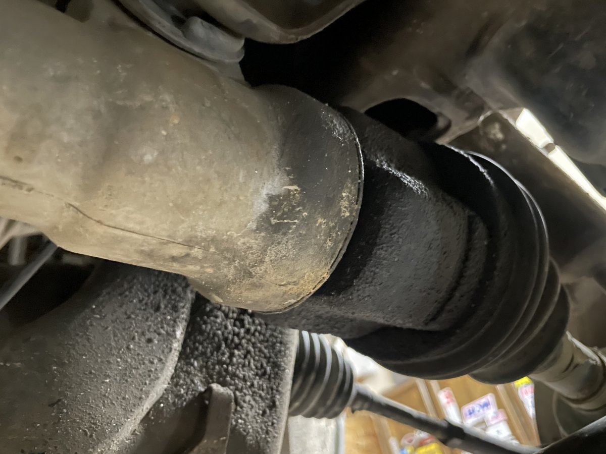

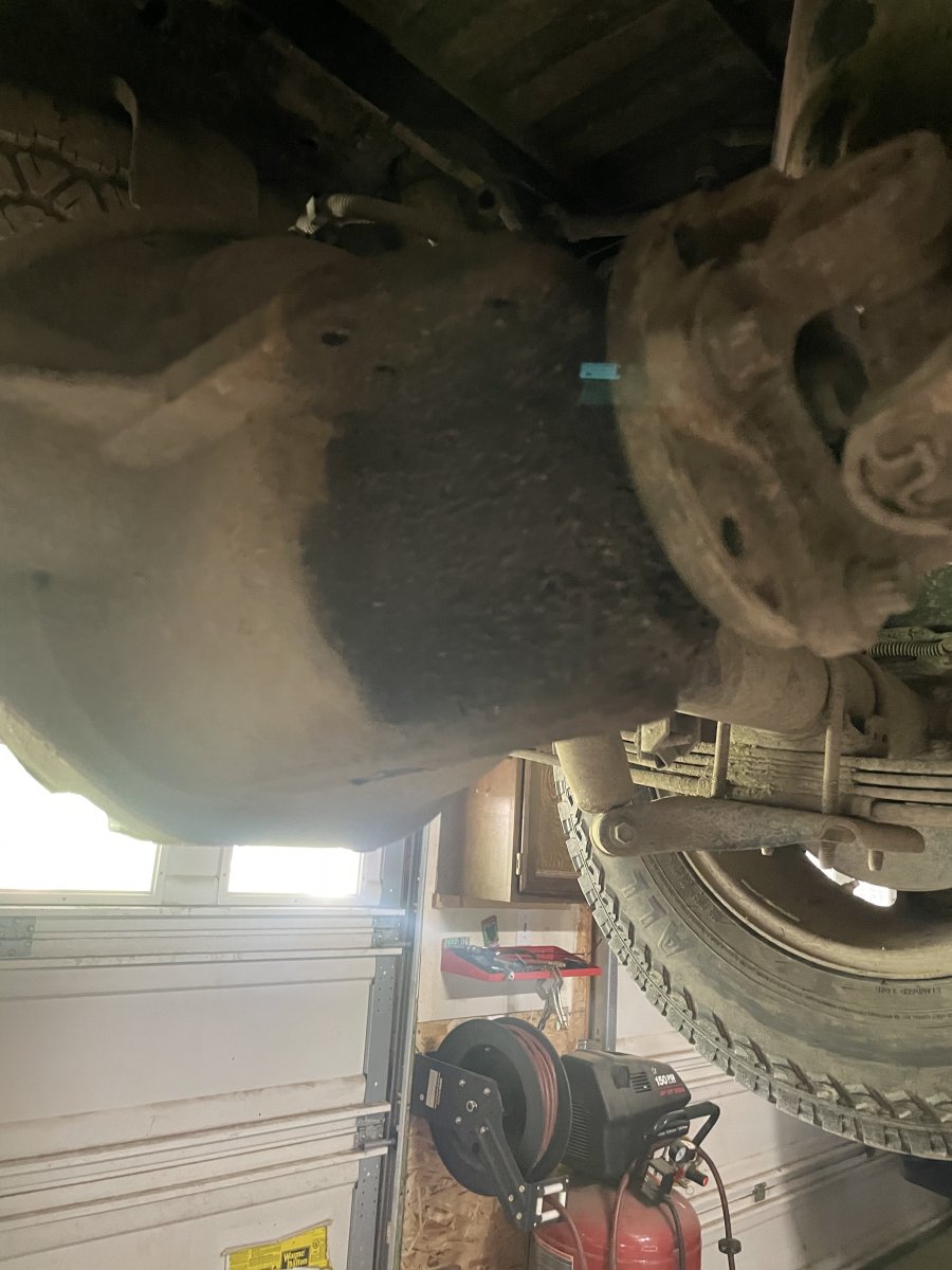

Front diff leaking both axle seals
Rear pinion leaking

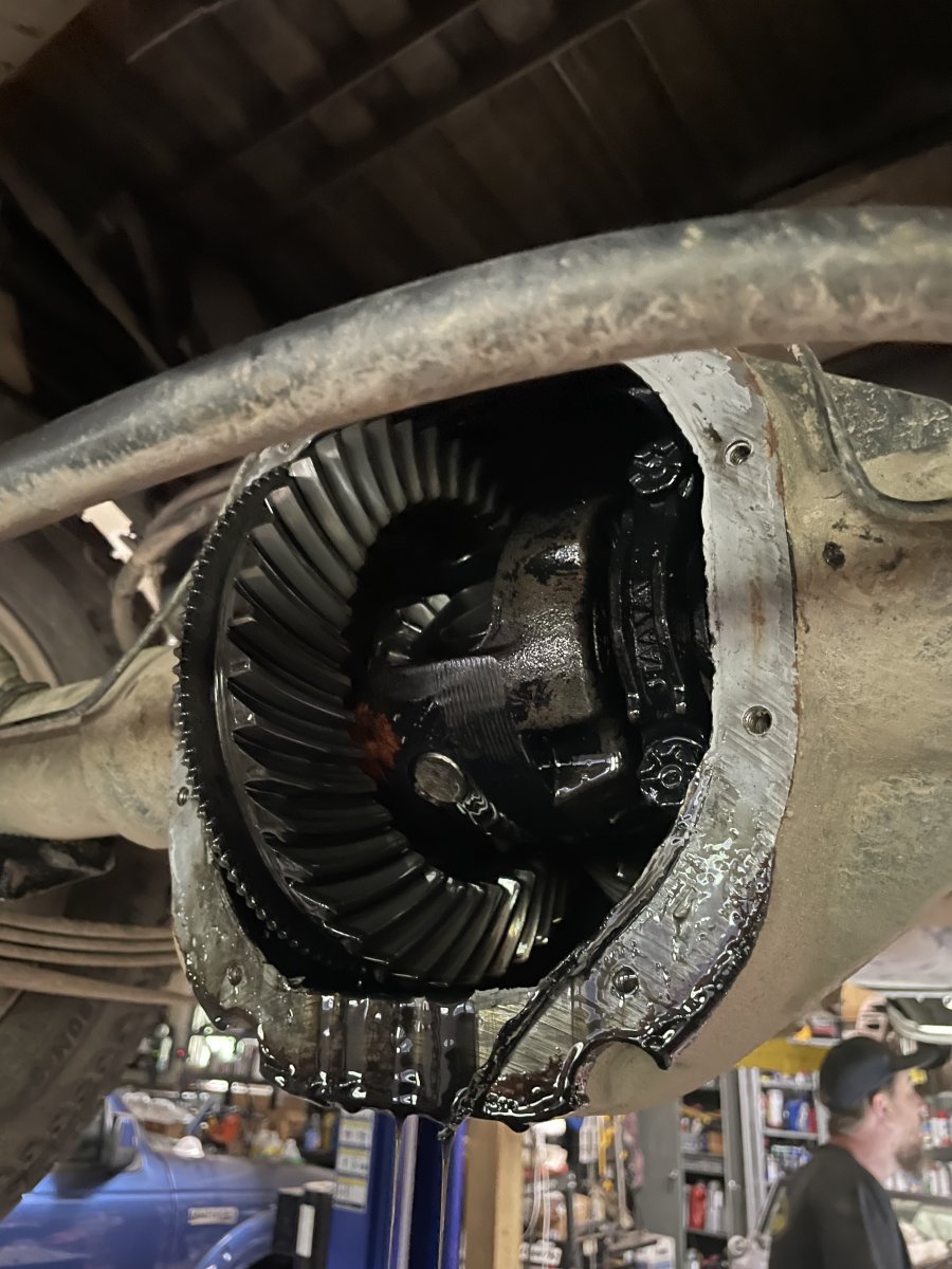

Serviced rear diff, t case and trans
31 spline 8.8 4.10 limited slip the best of the best!!

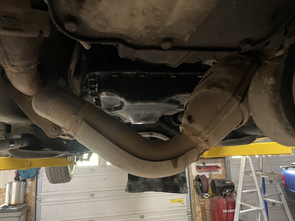

I just love how the exhaust hangs down below everything else on this year of trac not to self do not try to clear rocks down center of chassis
