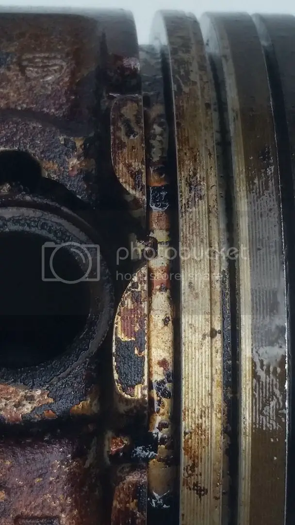

3 qts is a lot, take a good look at those ring lands to make sure they are not cracked.
Hope the weather changes for the better!

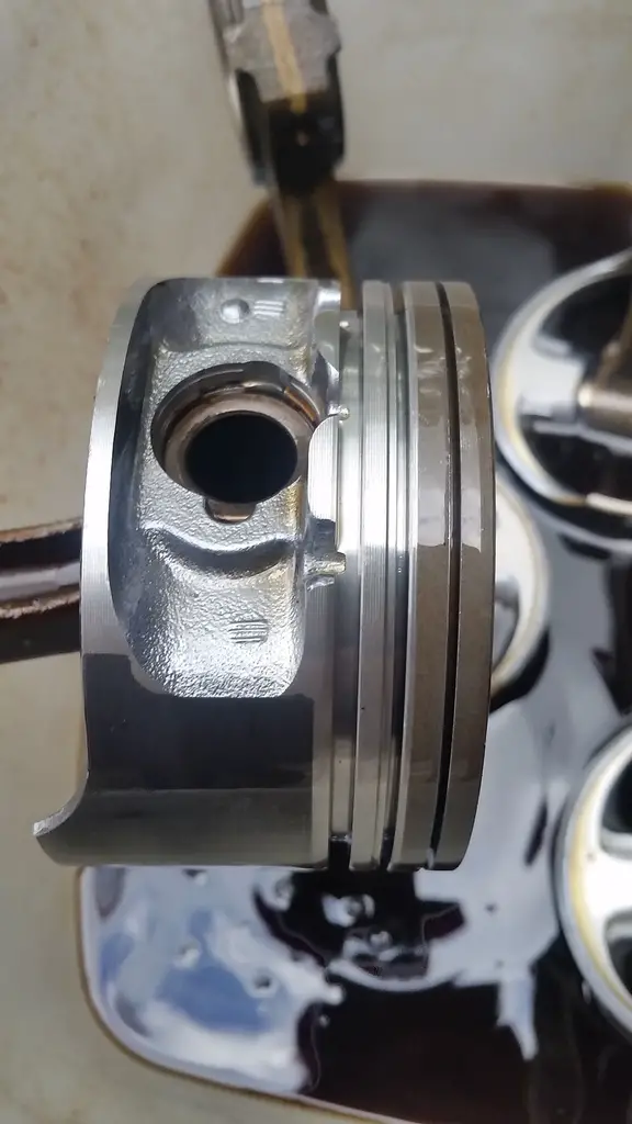

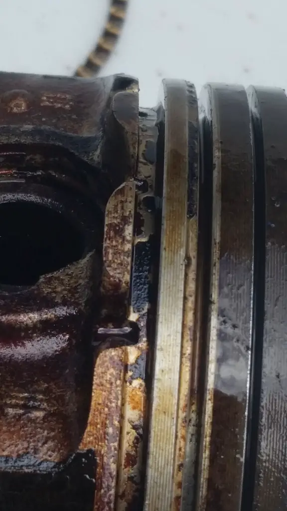

Appears the oil rings are clogged all up..
They all pretty much look like that

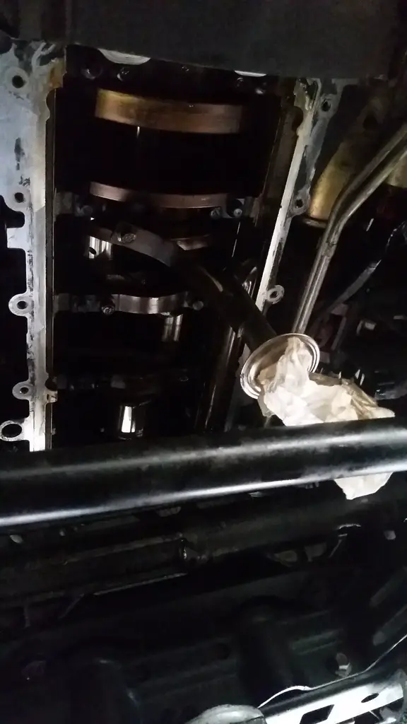

What does it take to get the oil pan off the bottom, can you do it with the engine still in the truck?
Any under engine pictures?

They've been out for couple hours now..soaking and tooth brushing them..they are coming pretty clean..little longer soak and final brush and should be good..
Pistons still have the coating on the sides..bearings all look pretty good
Took me 2 hours to get down to heads and hour this morning to get heads and pistons out..the pistons have been soaking with me cleaning them one by one for almost 3 hours..definitely the time consuming part..they are CHUNKY AND DIRTY!!
The pan can come off but the crossmember and sway bar have to come out..thankfully this truck is 2wd..
Best pic i can get

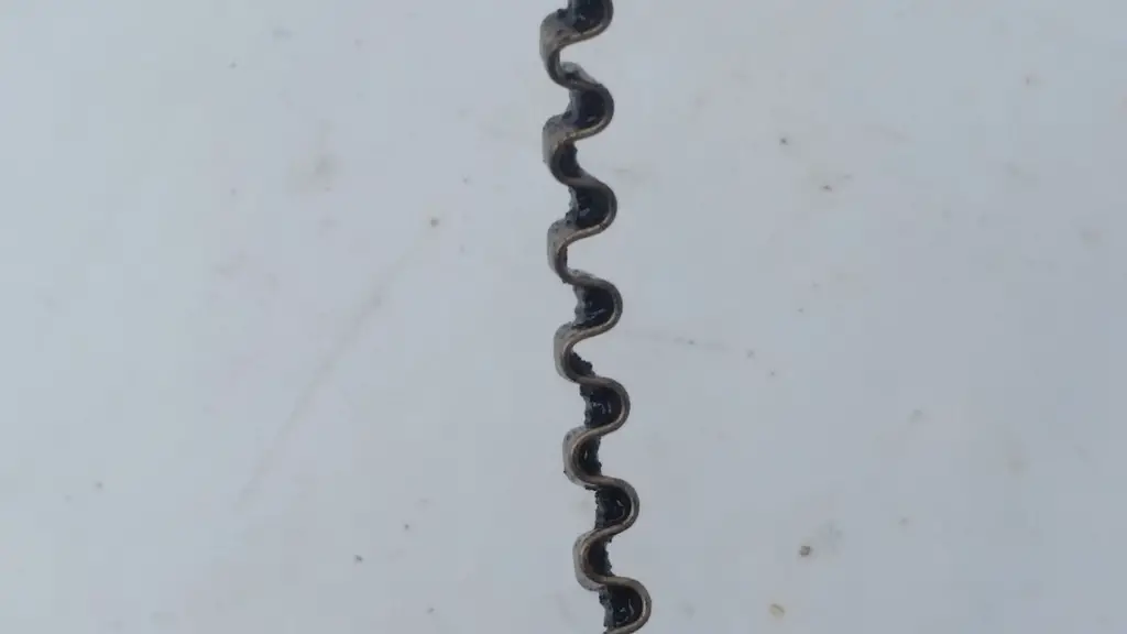

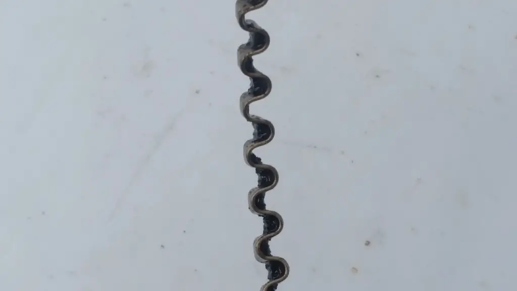

Got a problem. .the pistons that came out have a smaller top ring than the 2nd ring..
The replacement rings i bought from rock auto for my year has the same thickness rings for top and 2nd rings..they wont fit..
Now what??
Found my answers. .if you look the top two options are 1.5-1.5-3.0 and say ""DONT FIT OE PISTONS ""
the 3rd cheap set are 1.2-1.5-3.0 and will fit..
We measured the rings and they do measure 1.2-1.5-3.0
Only issue now is the ones that fit are .020 oversized...guess the search is on or new pistons will be ordered. .forged ones!!
Found them..MAHLE makes them in STD size with plasma-moly top ring..part number is 41789...
