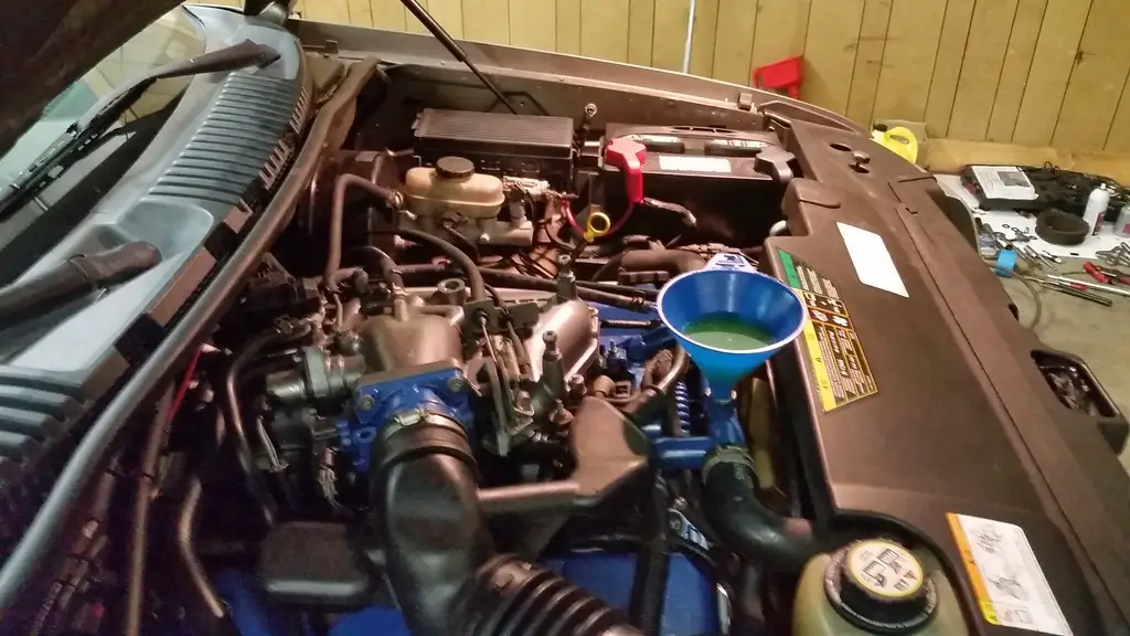

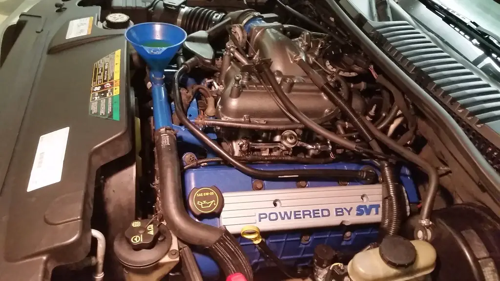

So he didnt pick it up yesterday. .called him this morning and offered for me to fix it and he take care of me on the 4.0 block he has..he agreed and said name anything i want..he also thanked me because now his guy can stay inside and build motors,hopefully correctly. .said he wasnt keen on working on someone's else's vehicle anyways..plus had never worked on a aviator, didnt even know what it was...

Looks good, nice job on the paint too!

Thanks and appreciate all your help also.. still need to fill the tranny up but that can wait till tomorrowLooks good, nice job on the paint too!
