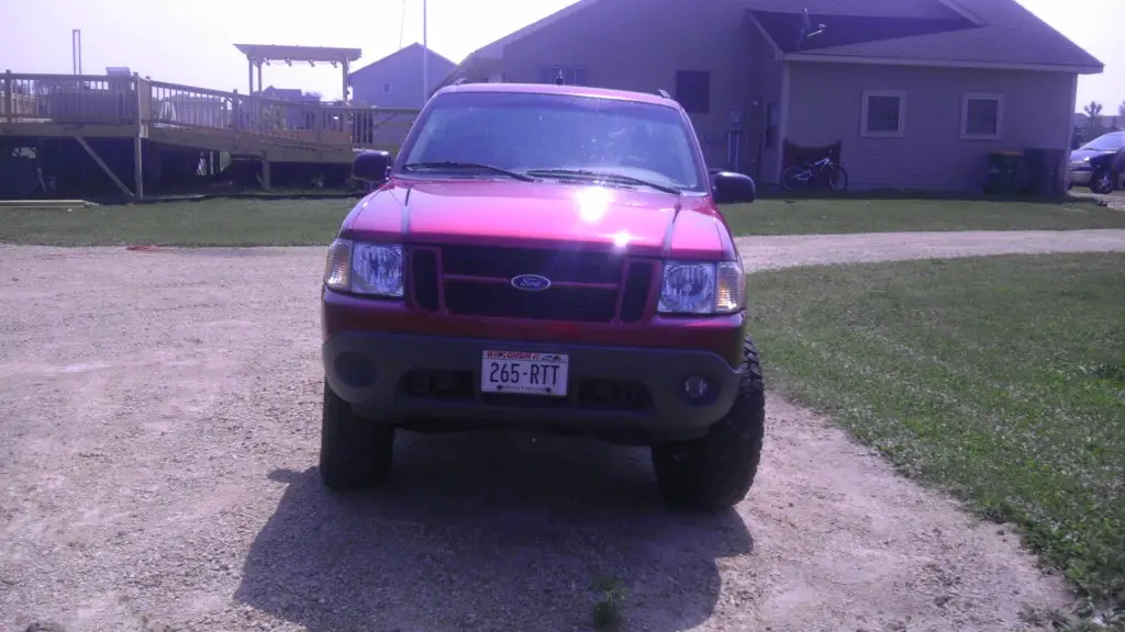

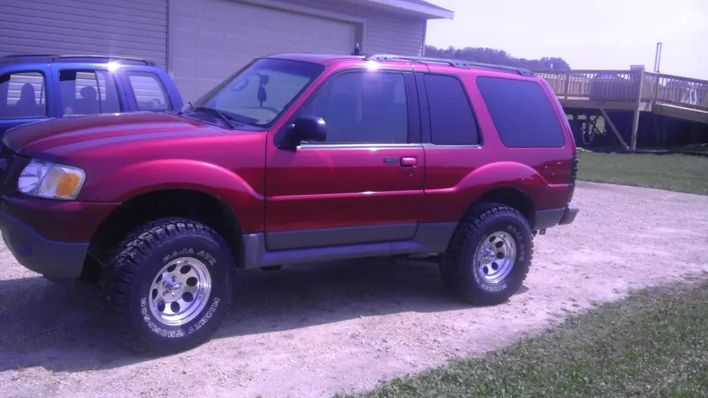

HERE IT IS THE MOMENT IVE BEEN WAITING FOR FOR THE PAST COUPLE MOUNTHS!!!!
Oh man that thing looks good!
I'm liking the look too! Do you have a hitch on your Sport?

Yeah very nice, enjoy the lift and 33's!!

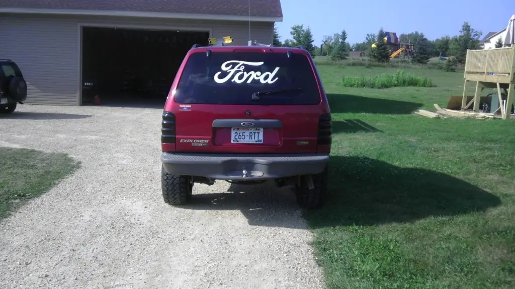

Thanks guys, no i do not have a hitch yet but i will be getting one or making a custom bumper with a receiver built in, Not sure yet but i really like it.

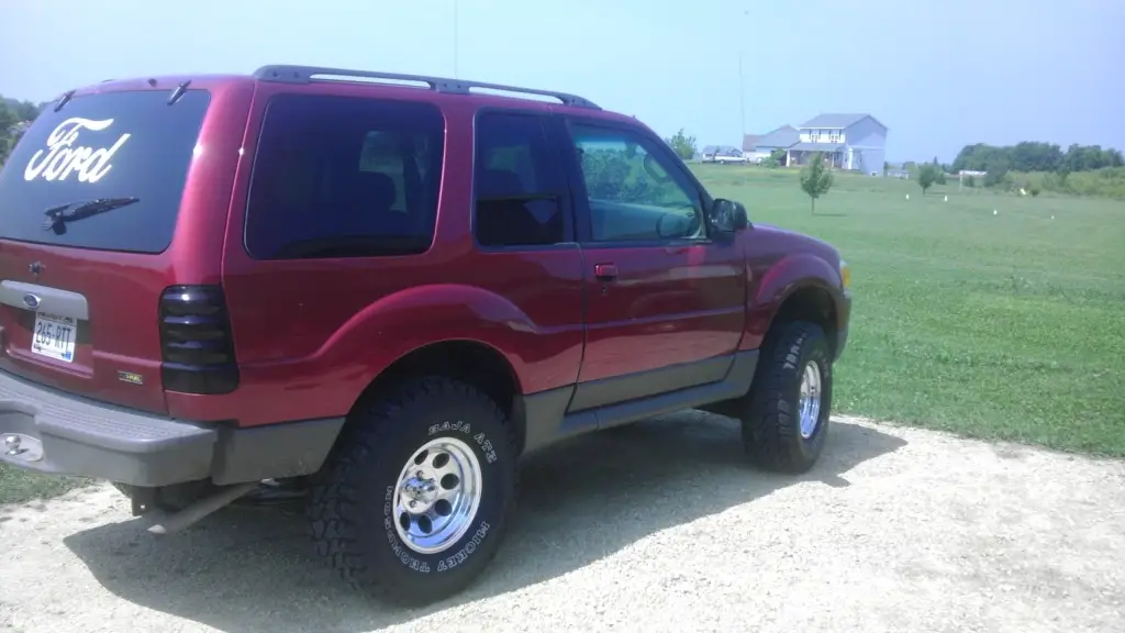

I think you might be mistaking my lazyness of not cutting the exses of the bumper bracket off
No I actually didn't notice the brackets. I was wondering how you went about fixing the gap between the hitch and bumper that happens after a BL. But you don't have one.
Oh the ranger kit comes with brackets and then i put them on my 12 ton press and got them flat, and they worked.
Ill post some close ups soon

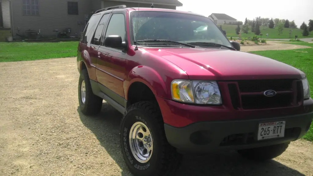

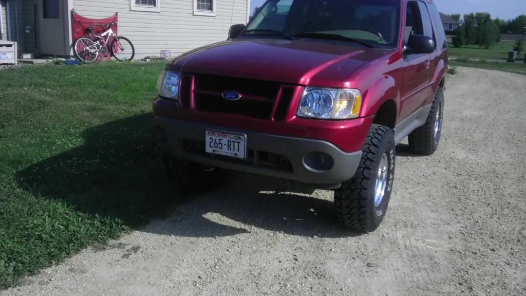

Close ups have arrived.
Sweet ride! I am in the middle of my 3" BL right now and should have it done tomorrow (finishing touches ont he body mount bolts and then off to the bumper's). To get this straight, no TT/Shackles yet?
There is a slight TT i don't remember how many times i twisted them but there not all the way in i waited until the day before i went into get a alignment to twist them so i didn't have to worry about it pulling a lot or anything, but there is still not shackles nor a add-a-leaf yet, Mainly because desert rat seems like they don't wanna sell me anything, so i haven't got shackles, my 33 inch mickey thompson's don't rub anywhere besides the front lower part of my bumper trim, other then that they don't rub anywhere but i haven't taken it off road because im waiting for my shackles.
