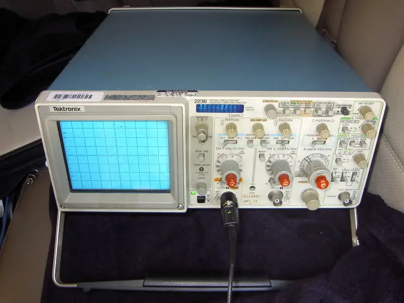

Tuned with an oscilloscope to check for clipping
