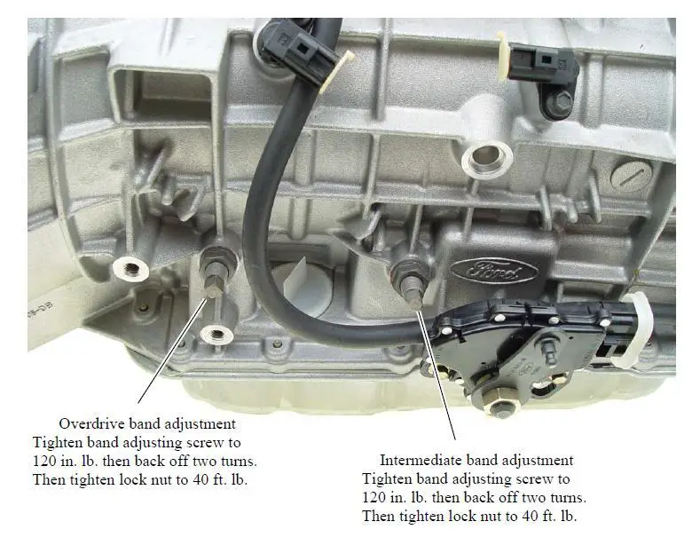

The computer has seen a problem with the transmission, when this happens the computer sets a code and maxes the line pressure to help protect the transmission, that's why the hard shift.
Based on your codes and your description 3rd gear is not engaging. Most likely the intermediate band has broken or the intermediate servo has failed, that is what the most common reasons are for this issue.
One way to help figure it out would be to see how many time the intermediate band adjustment bolt will turn in, if it turns in more that 3 turns there is a good chance the band is broken. If the band has broken the transmission will have to come out of the vehicle to be repaired/rebuilt.
If the band tightens around 2 turns the band could be fine and the servo could be the issue. The servos have a tendency to crack.
