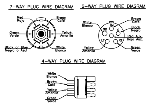

+1 on volt meter at the socket. Also: Check your towing harness, two of them if equipped.
Flat 4: Ground is the obvious one, left stop/TURN is in the middle of the remaining 3
Round 7 pin: Left Turn is at 3:00 position
Check the wiring harness that feeds these plugs. A wire that is damaged or broken could be the culprit.
