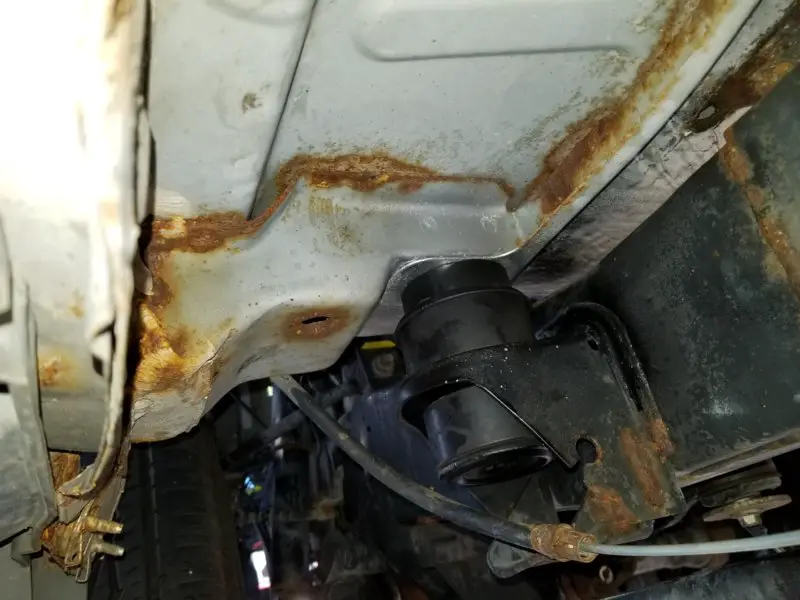

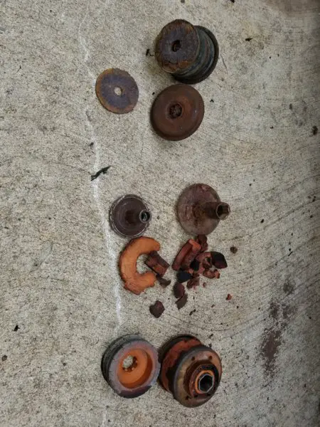

Body Mount Bushings Kit - 2001 to 2003 Ford Explorer Sport - DST dfm002 from www.suspension.com for $162.66. This is the only body bushing kit that is made for 2001 to 2003 Ex Sport and it fits perfectly. I just did mine and I added a 1in spacer between the mount and the body. Wow, I now have room to work with my 302 swap. I had to replace all the bolts and washers because of the additional lift. As you can see the original mounts were toastView attachment 163838 View attachment 163839
