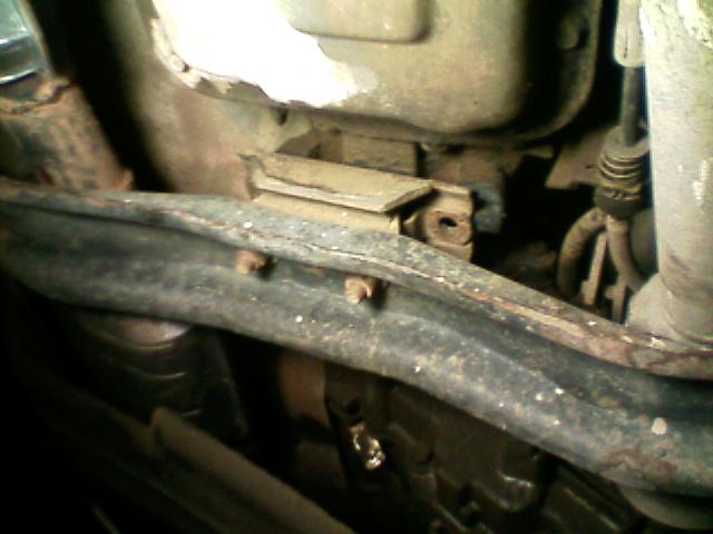

NOW the discovery, I found out 2 bolts holding the rear of the tranny were missing (I guess thats what happens when you take your friend's truck to Truckhaven). so this thing is pretty loose and there is a lot of movement on the transfer case.

Here's a pic of how I found the missing bolts.

So both of the upper tranny mount bolts were gone? If that's the case I would definitely check out the U-joints because they would have been getting hammered while you were attempting the climb. The whole driveline must have been bouncing all over the place.
Yes for the drive shaft bolts you have to kick it in and out of gear to move the drive shaft around while wrenching. I believe its either a 12 or 13 mm wrench.....
ummm yup, I just went outside long enough to get greasy again and found what I think the clanking was. Not only was there marks all over the driveline, and I did notice the rear driveshaft looked awfully close the the gas tank, but the double cardigan joint was pretty much resting on the crossmember. It didn't get driven too long like this, but it did have some marks on there. Here is how it's sitting and I cannot move it side to side. Probably going to try to use a come-a-long first and realign this and see if I can get it to shift, because again, it looks next to impossible to get at those 5 bolts.
