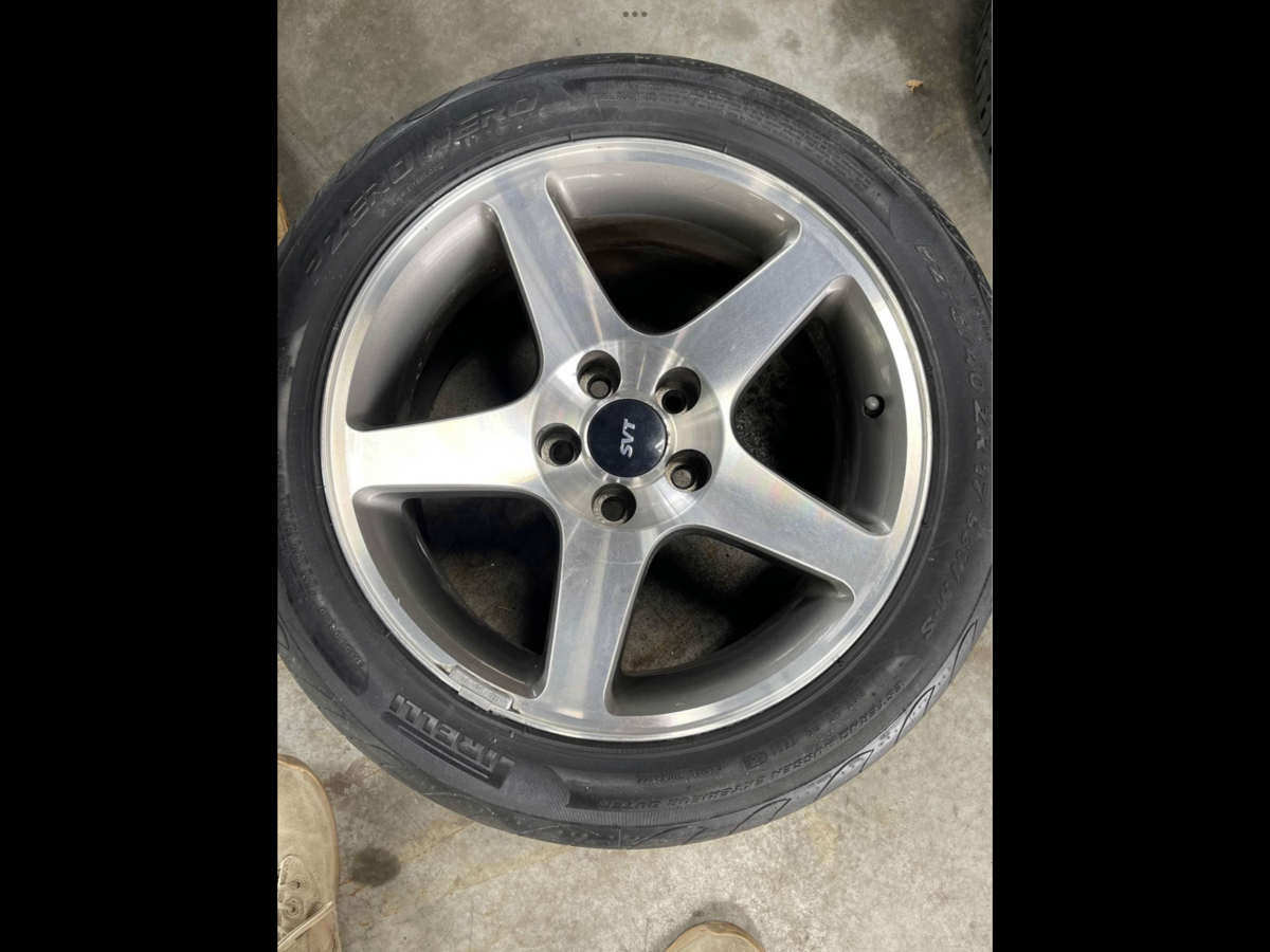

I’ve found these late model explorer wheels that I’ve always liked. I know they are 18x8 ET 44 Which is a real high offset. I know I’ll need spacers. I’ve found a place that makes bolt on adapters made in USA with hub centric hubs on both sides. They make them in steel and aluminum. Any feedback from anyone that’s used a fwd offset like this with adapters? I can get these wheels for a couple hundred bucks so it makes the whole deal doable.

Those wheels and 1" spacers would make them about a 20mm offset. For that price, it might not be too bad to test fit them and see where they end up. We can help to guess how the possibilities will place the tires etc, but each combination is different. You likely will have to install something to truly know what size/specs will be your ideal. The 8" and 9" wheels will fit much easier than 10" wheels, so try to stick with those.

What do you think about a 9” wide wheel with a 26mm offset? Would that be just throw it on, no spacer necessary ya think?
That would be very close on the inside to the BJ's, the tire is close on my Mercury with 8.5" wheels(18x8.5 and 29mm offset). I think that 9" may fit depending on the tire and how much it bulges on that wheel.

I had 265/60/18's on these wheels first, then 255/60's, and now my 2nd set of 255/55/18 tires. None of them rubbed on the inside, but the first 30.5" tires rubbed with the tread on the inner fender liner(the top has plastic protruding down).
With those 275mm tires and the slight 3mm more offset, they will be close inside. I'd say it has a good chance to fit, but it's pushing the clearances in all directions; I think that will be closely centered in the best position.
My 275/55/17's will be tight too, but as I posted before, the 16mm offset will swing mine outside more, rubbing the front or back of the fender will be my tightest spot.

Ok. I can deal with them if they’re rubbing the ball joint with a small spacer, I just don’t want them poking out the fender. If they’re flush with a spacer that could be an issue too after lowering.

Do you know off hand what the measurement is from the wheel mounting face of the rotor to the bj? This 26mm offset 9 would make it 5.5” from the mounting pad to the inside lip and 3.5 to the outside lip. If you don’t know that measurement by memory, I’ll just measure it tomorrow.
