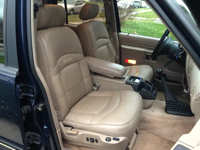

Any seat track will work from 92-97 (remember, 91's had a different floor pan, and thus the tracks are different) but the seats themselves, any 91-01 explorer seat will bolt to your existing power seat track. if it's still functional, you need not buy a new track when you buy a new seat. The only exception to this is if you want to install memory seats, which does require the memory seat track.
I used '98 Mounty seats on my '94 tracks. I had to change out the switches for the lumber because the plugs were a different orientation.
I then put '99 Limited seats with tracks and all (removed memory). Very simple to switch seats around in these.
