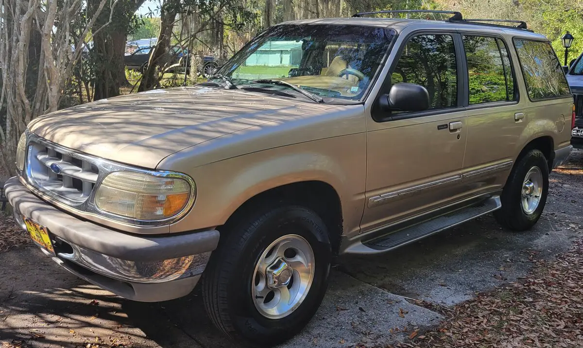

1995 Explorer XLT Instrument cluster malfunction
They lied to you the 95 computer has absolutely no idea how
Many miles You have traveled there is no internal odometer in memory
Did the cluster come from the same exact year? It is possible the abs light is on because cluster came from a slightly different model? Compare the bulb location to your old cluster
Otherwise you should check the abs system for a trouble code
I'll do that then. Thanks again for the reply. So it doesn't need to be coded or anything to my vehicles vin umber that could be making it accelerate funny?
No there is no coding in these instrument clusters
OK thanks seems like everything is working on it now. Thanks everyone for the help. Glad I joined this forum. U all are very supportive.
