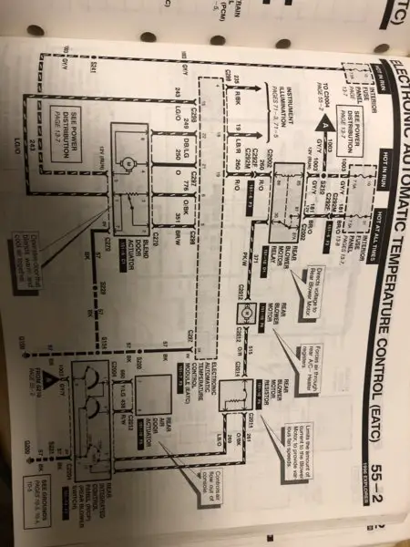

EATC - Electronic Automatic Temperature Control
Well, I replaced the EATC unit with the one from the parted out Explorer, a vehicle with 70K original miles.
Works like it should now. A steal at $15!
Any value in the old EATC unit? It worked well except for not sending the signal to the compressor. It's a two year only 96-97 EATC unit that is red in color.
If the replacement lasts half as long as the original I'll still be way ahead.
