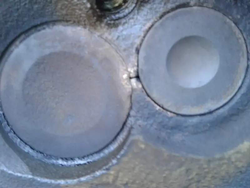

Yes I am using the plug wires with retaining clips on them and lots of dielectric grease on both ends. I come from a marine world with mercruiser (chevy) engines, and its drilled into me about the grease to keep moisture out. The number 4 plug is such a pain to get snapped on with the egr in the way and the angle. The cables have been off the battery for a couple of days since I had to go out of town. Boats are so much easier to work on vs these new fangled motors with tons of sensors and hoses lol. This is the cracked head from before.

Seems like every few days an ohv explorer is checking in with this problem. The likely cause is a crack in the head. You have two options:
1) Repair the head, it is a permanent solution. There is a set of new heads on ebay for 400 bucks. Add $100 or so for gaskets and stuff.
2) K-seal, this is what I did on mine, seems to be holding very well. It will plug the crack. How long it lasts, I don't know. I have 5k miles so far. But my truck has some rust and it won't be around forever.
