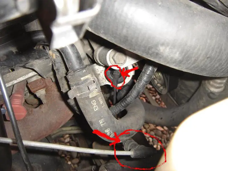

Does yours look like this? I would guess it goes to the heater control valve. This photo is up top. My 97 is down under the alternator (a pain to get to)
Hope this helps.

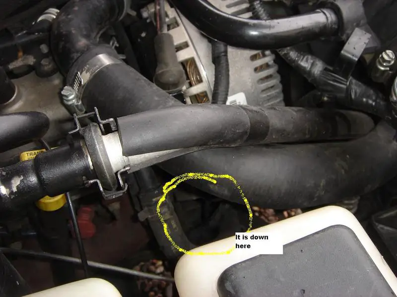

Here are a couple of photos of mine this morning. The one vac line plugs into another one that goes down to the heater control valve. When I got mine the one from the valve was broken. What a pain to get down to. I like the one up top as my son's 95 has. Hope this helps.
