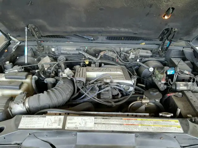

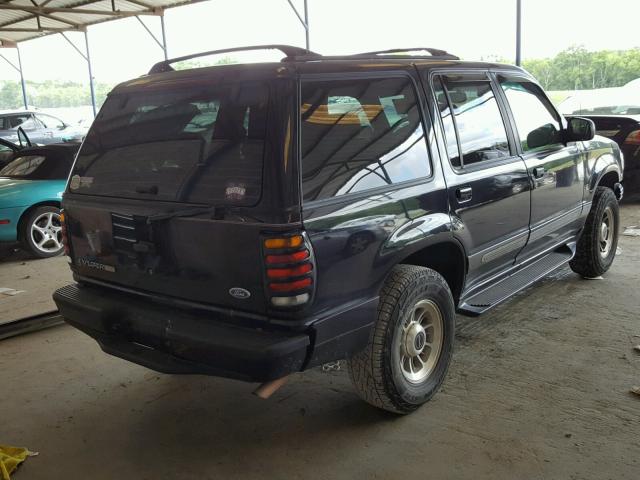

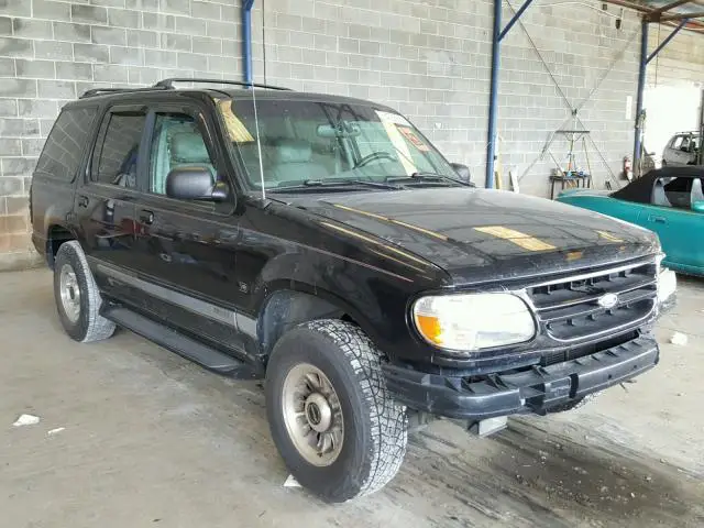

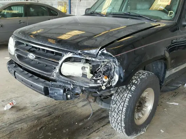

Fast forward to a month ago, I saw a black 97 Limited V8 2WD pop up on Copart in Atlanta GA. The damage it took up front was body panel replacement and hammering the Limited/Sport only bumper bracket welded on the front.
So for the cost of it, plus transit to my home in Columbia, SC I had a new project. Transit cost more than it did lol

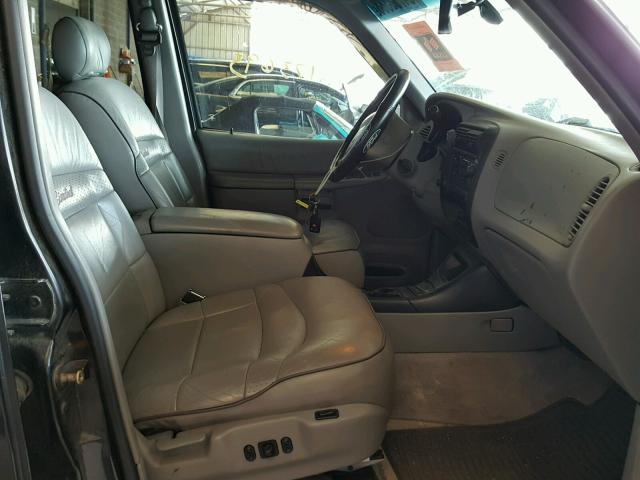

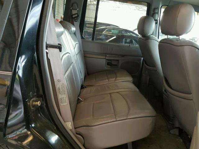

Carfax had impeccable maintenance history at local Atlanta Ford dealers. The oil cap underside backs it up. Has newer lower ball joints and upper a arms with ball joints. Recent AC compressor & accumulator. Also has barely 2 year old Pirelli tires. Two layers of floor marts. Recent upper/lower hoses and radiator. It's a super nice respectable ride. The leather isn't ripped - but it does need treatment, its dry. Driver side leather is worn a bit much sadly...maybe I'll find some nicer 95-98 gray limited leather one day. The roof paint is dead, all clear gone. Steering wheel foam under leather is dead. Cruise buttons are mint oddly?

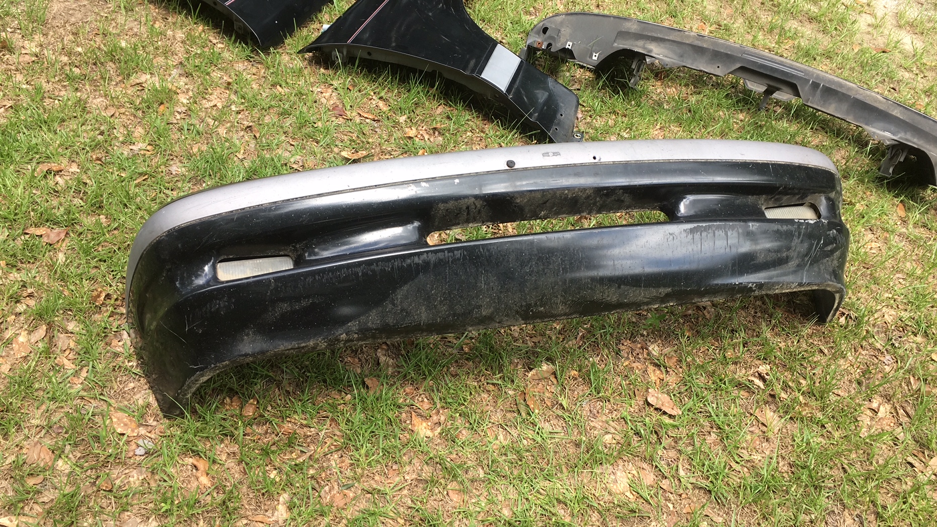

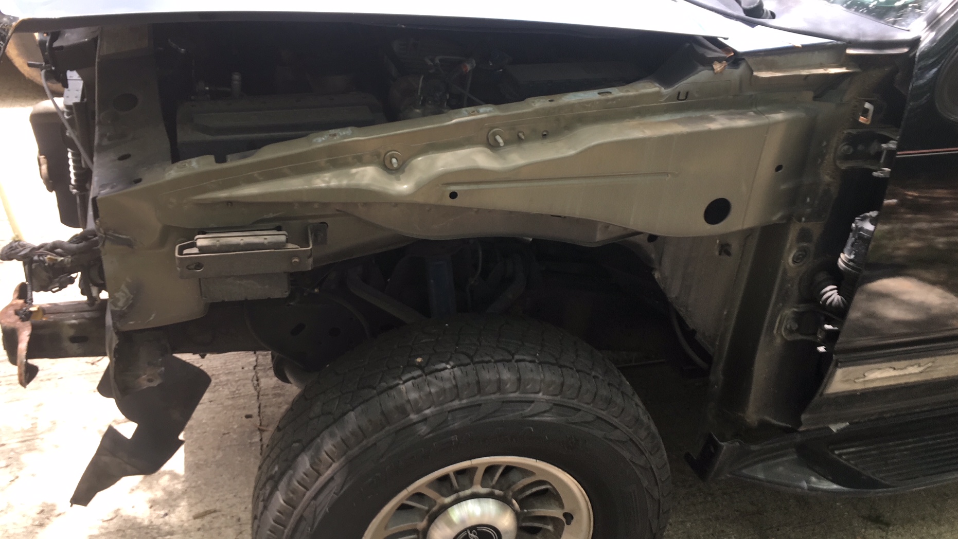

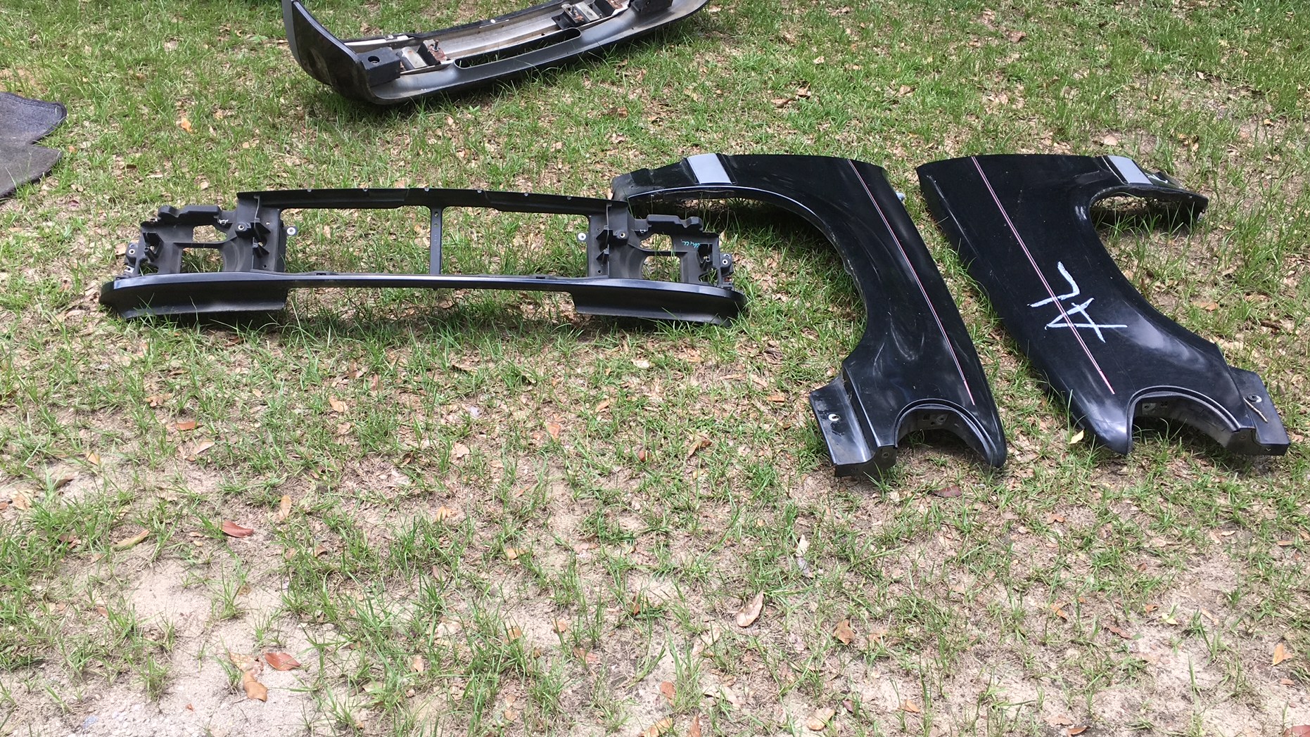

First order of business was replacing body panels. So courtesy of the wonderful self service junkyards, I sourced a replacement OK painted black hood, a correct Limited fender from a 95, a replacement OK header panel, and a Limited bumper. I ordered a new Limited grill. After I have the bumper and grill painted painted, I'll leave it at that for body stuff this year - prove its worth before I have the roof painted lol I installed mostly everything. Had to hammer back out the corner of the metal welded in core support, it was a little crunched in next to the body mount - nothing structural behind it except a pass through for wires and some wire clips hand on there. Also the fender brace. Big deal.

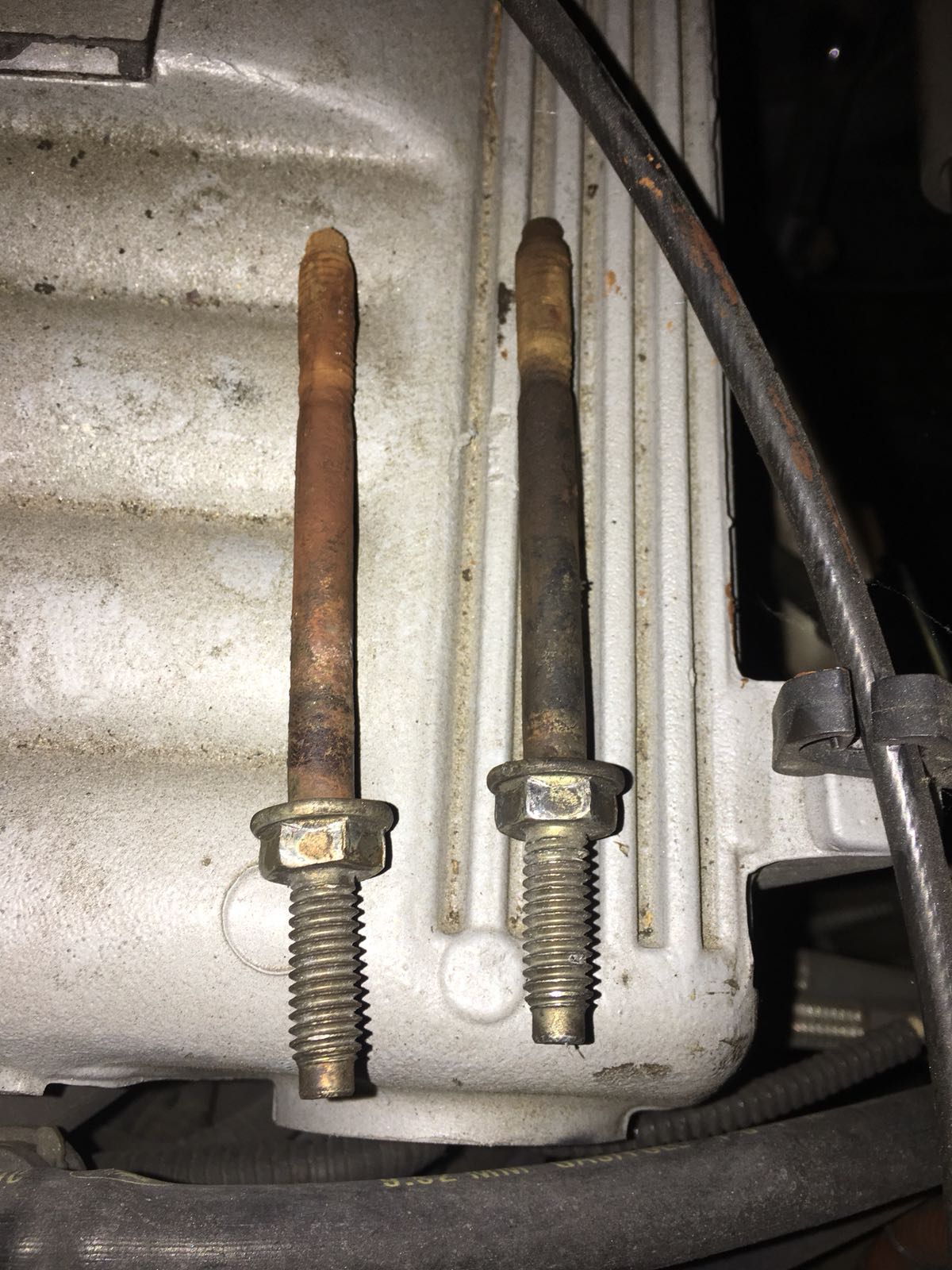

The oil pan does look a bit damp towards drain plug - maybe lower intake gasket seeping oil? I'll have to look more. Thinking to do a drain/fill on the trans and install a Dorman pan w/drain plug.
