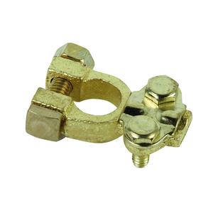

Maybe consider switching your terminals to 100% solid brass ones, and using treated battery terminal felt washers. I did that on mine. That should reduce/eliminate your corrosion buildup issues. I had to file the insides where the post go since they were way rough from casting. One of them fits great, the other one was tight and had to be knocked down a bit with a dead blow hammer.
Something like this:
