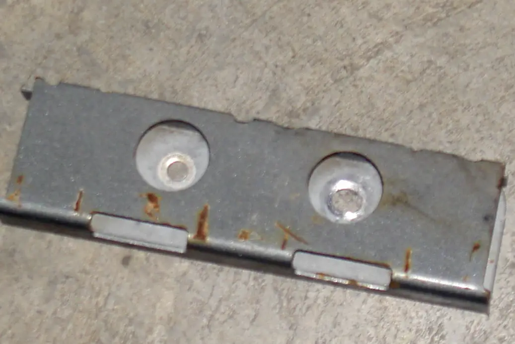

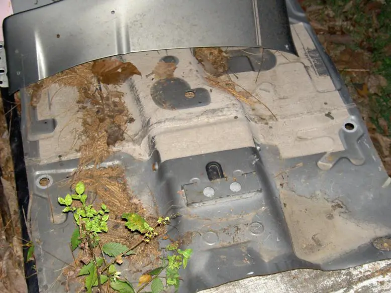

The 93 Limited I had with the console had air ducts exiting at the back of it. I don't know how well that worked for passengers. I used my 93 body(rear clip) to repair/rebuild a wrecked 99 Limited. So I'm familiar with the full length consoles of the 95-01's.
You can mount that big console in the 1st gen's, but it does mount with two bolts into the dash, two into the floor, plus a unique mount at the back(riveted to the floor). You can get that rear mount and attach it to your floor, I'm not sure how the front of the console would mate to your dash. Those full length consoles have wiring harnesses in them which disconnect at the dash. There's a ton of wires in those, a bunch for the radio plus the secondary 20a power outlet.
