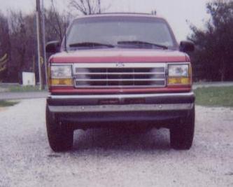

i just did it, at first the wheels looks terrible really bowed in at the bottom. but once i drove the came back out some. heres a pic of them after i drove it. also i drove it for a week before alignment and no problems.

You can drive it without an alingment, but it will eat the outside edges of the tires rapidly. I drove mine for a week before I had time to aling it.
yes thanks for adding that. i wouldnt go for much more than a week on some short trips.
You could save your tires and some money by buying some 2.75* camber shims ahead of time and install them when you put the spacers in. Also you can adjust the toe with a tape measure. Set the measurement at the back of the tire and the front of the tire to the same or in 1/16", either way its going to be off some so I just set it the same when I do it.
