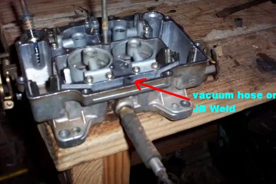

4- There is a transfer passage on the backside that allows fuel to flow between the bowls. Block this off with a piece of vacuum hose. It doesnt have to be a perfect seal, just block most of it. If you dont, when leaned over the fuel will run out of one bowl into the other and flood.
