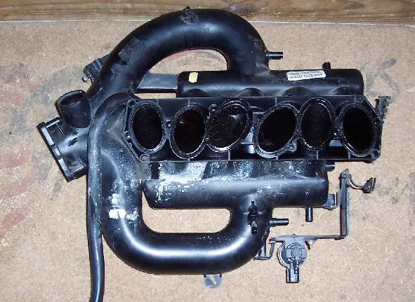

Since the 1998 has VIS there is wiring for the VIS vacuum solenoid but the 2000 does not have VIS. The PCM pin for VIS was switched to the fuel filler cap. If you don't have the 2000 engine wiring harness it will be easier if you purchase one. They are often available at a salvage yard or on eBay. You'll also need the 2000 fuel rails with a single fuel line connection to the fuel tank and a fuel pressure damper instead of a fuel pressure regulator. You could probably get by using the 1998 upper intake manifold with the VIS inoperative. If you want the engine to be a stock 2000 configuration you'll need to purchase a 1999, 2000, or possibly 2001 upper intake manifold that looks like the one shown below.

My upper intake looks just like that so far everything looks the same just that vis canister and a fuel pressure regulator on the motor
VIS vacuum actuator
Look for the VIS vacuum actuator on the upper intake manifold just aft of the IAC valve. There should be a rod connecting the vacuum actuator to a lever arm that controls the variable length intake runners. On VIS at 3,000 rpm the PCM energizes the vacuum solenoid which activates the vacuum actuator rotating the lever that shortens the intake runners. If you use the VIS manifold there will only be a small degradation in performance vs the stock 2000 intake manifold.
